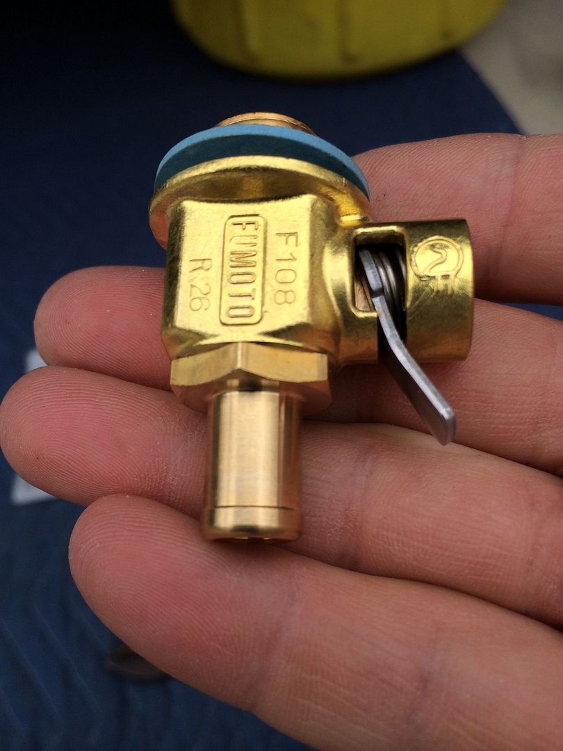

Here's what it looks like "closed". Note the position of the silver "tab" above the "F108" imprint.

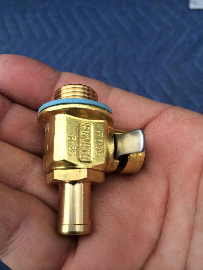

You can see that the silver tab is now in the "open" or "drain" position.

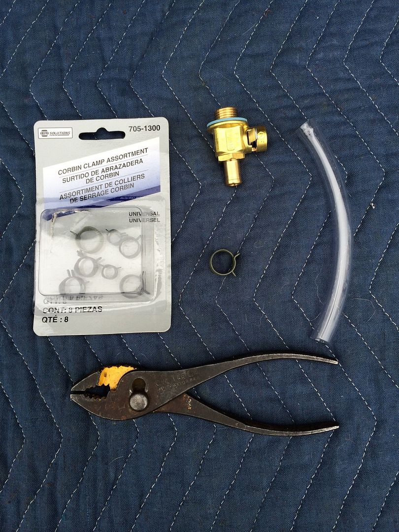

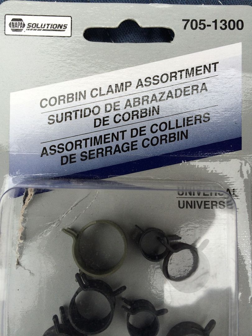

To "lock" the silver tab in the closed position, I got a variety – pack of Corbin clamps.
The 5/8" (1.58cm) clamp was the perfect size.

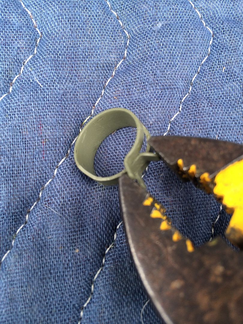

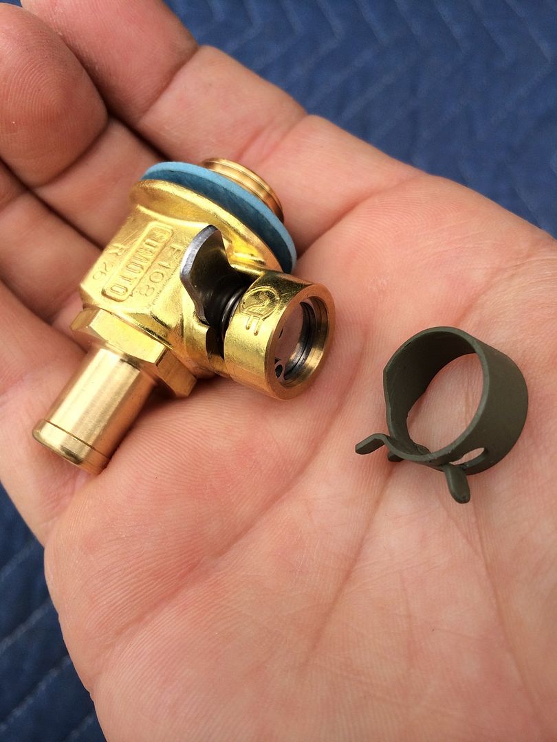

Those of you with Iron Man finger strength may be able to squeeze the clamp without tools. I used pliers. When you pinch as shown, the diameter of the little clamp increases enough to slip the clamp over the side of the Fomoto valve.

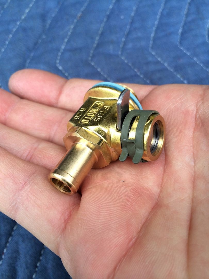

With the Corbin clamp now powerfully gripping the Fumoto valve (keeping that silver tab from being able to be moved), the likelihood of accidental oil drainage is diminished.
It was a very simple modification that didn't cost much, and only took a couple of minutes to complete.
