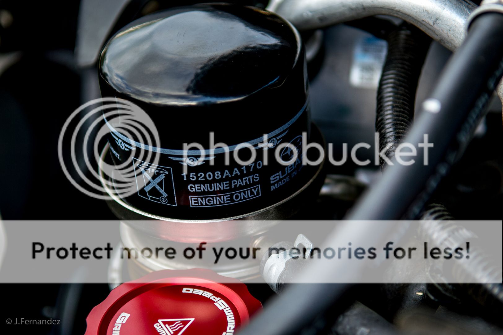

Just did oil change and now using 15 WRX filter -170. Tokyo Roki made.
I will be sticking to this, before I was using -130.
That filter looks wider. Do you know the capacity or how large the filter media is for it? Stats on it? Everything working ok so far?
Yeah its wider than the blue. As for specs, I don't know. Subaru doesn't release them. Working fine, there's no reason why it shouldn't work. I rather use Tokyo Roki made than Canada. Just my preference.

What made you switch to this one from the -130? I'm guessing it's shorter than the -15A(might actually be the same size filter media). I agree with the quality is probably better than the Honeywell/Fram made -15A. I laugh at the lil toy oil filter on these cars each time I open my hood :icon_eek:

Yeah the 130 and 170 are shorter but wider. It's somewhere on this forum but someone mentioned the 130 has much higher filtration than the 15a. Since the 170 is for the WRX, I am sure it's same filtration level or even more? The 130 is for the BRZ so I figure I stick to WRX 170 since we share same platform.
It's crazy to me that there are different filters made and recommended by Subaru for the FA20DIT engines depending on what car they are in. I agree with you on using the 2015 WRX filter (170).
Doesn't the fa20dit in the wrx have slightly different internals and specs than the one in the forester? Maybe that's why?
