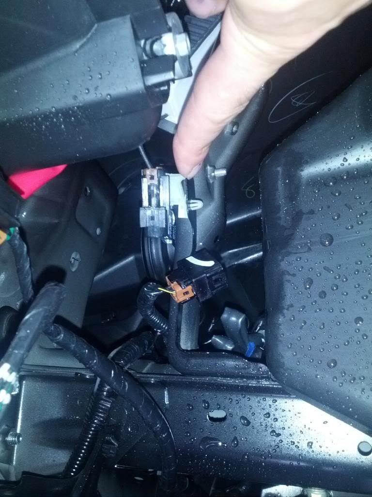

Found it! Woo hoo!
I was reluctant to start ripping apart my BSN* Forester, but in the end I decided to take a quick peek, removing as little as possible. Turns out, it's AMAZINGLY EASY!!!
Remove the air intake duct from the front of the engine bay by removing two screw/clips. Just turn counter clockwise until they pop up a bit, then slowly and gently pry them up and out:
This leaves a sizable opening in the right side of the bay, giving you access to all kinds of stuff:
On the left side, kinda under the headlight connections, you will see a paired up black/orange connector, and to the left of it, the big tell-tale grey resistor! AH HA! Shown here disconnected:
The connectors have one flap that holds them together (there's not another one on the bottom. I carefully removed it and checked so you wouldn't have to. You're welcome!). Pry up the flap gently and disconnect the connectors. And you are DONE.
Tie it back, tape off the openings, etc, as desired. Slide the air intake duct back into the filter box, align it to the mount holes and pop back in the screw/clips, and viola! Done!
Tested. Works. Easy.
* BSN = Brand Spank'n New

Um having trouble finding this...the pic of the clips ...is that from underneath car or top? Is the connector on the side where we remove the intake duct or opposite
Shoot...wonder if I have it...I'm in a base 2.5i
