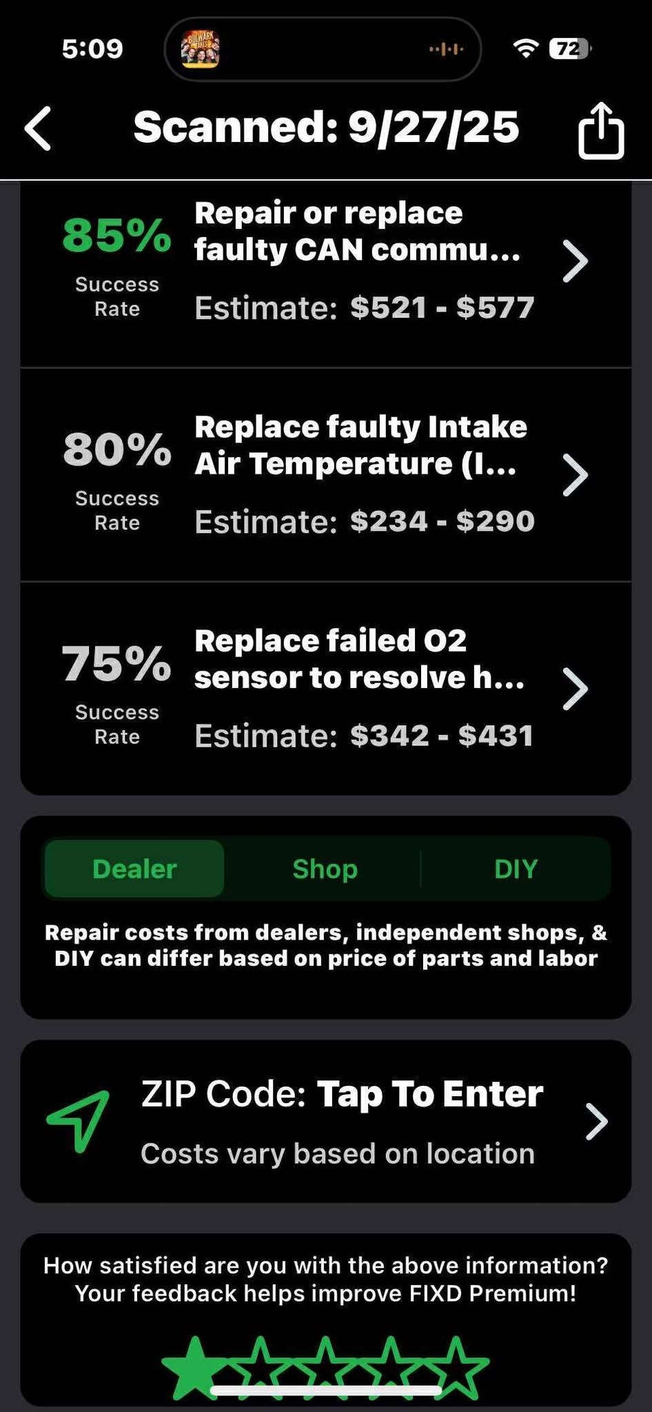

wanting to buy: 2019 Forester Sport - 146K miles - What should I know and what about the following/attached error codes. If this is the wrong forum, I apologize and kindly ask for guidance.
All opionions, suggestions and advice are greatly appreciated!
Thanks!
P1603 - CAN Communication Bus Error
Severity - High
U0156 - Lost Communication With Information Center 'A'
Severity - High
U0162 - Lost Communication With Navigation Display Module
Severity - High
U0230 - Lost Communication With Rear Gate Module
Severity - High
U0457 - Invalid Data Received From Information Center 'A'
Severity - High
U1712 - Unknown Issue
Severity - High
P0060-21 - O2 Sensor Heater
Severity - High
P0065-45 - Air Assisted Injector Control Range/Performance
Severity - High
B14A1 - Unknown Issue
Severity - High
P0065-44 - Air Assisted Injector Control Range/Performance
Severity - High
P00AA-0E - Intake Air Temp Sensor
Severity - High
P00AA-15 - Intake Air Temp Sensor
Severity - High
