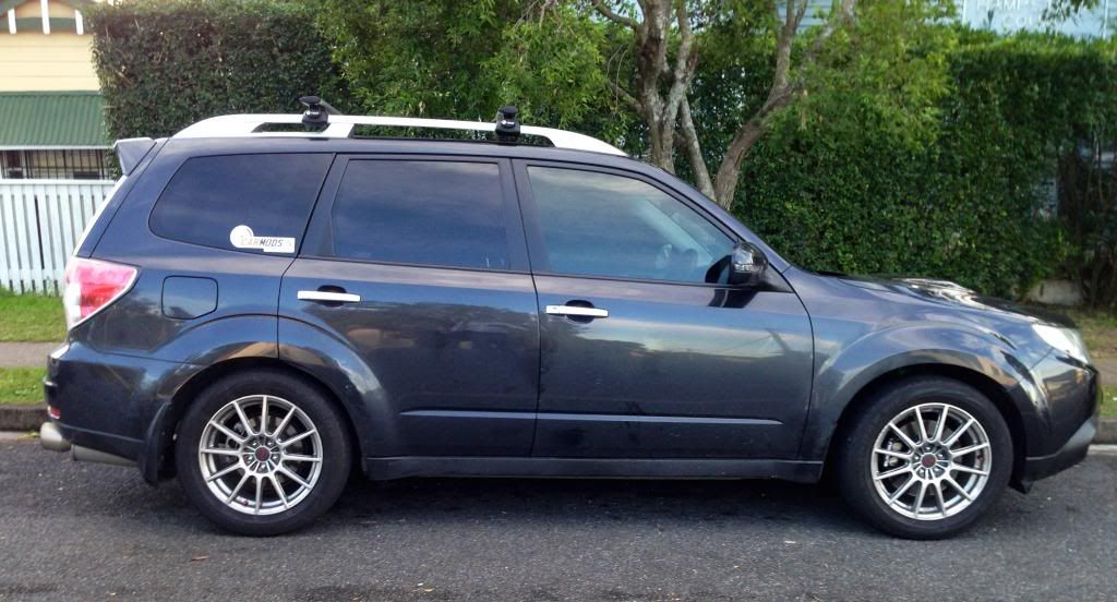

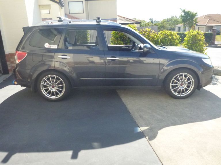

This is what the FXT looked like before being retired:
Only mods were the resonectomy and some aftermarket wheels.

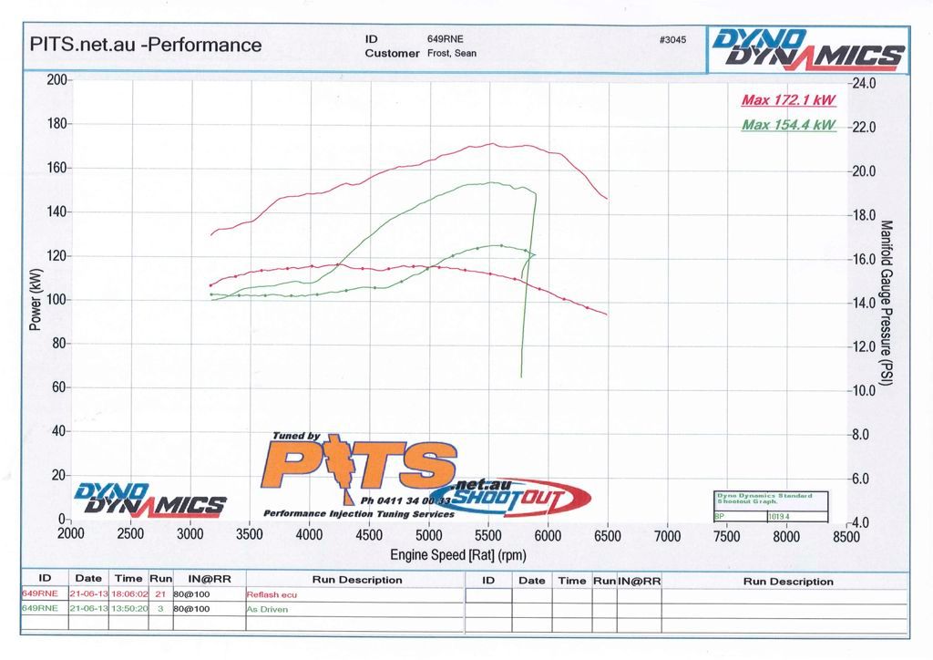

Tuning was done by a place called PiTS on the Gold Coast, QLD Aus. Results are as per the graph:
(green curve is the stock tune with the performance mods installed, so computer had 'learned' a little...as you can see, though, serious 'turbo lag'; power delivery is sooooo much smoother now!)
I was really happy with the results:
- low boost (15.5 psi peak is pretty low for the VF52; factory tune is ~14 psi)
- solid mid-range (what I wanted)
- fairly beefy torque
- more than stock (stock is ~182 hp)
It feels slower than than the 231 hp it's producing at the wheels, and I think that's because of the the delivery; very linear, no real sharp increase in power anywhere in the rev-range.

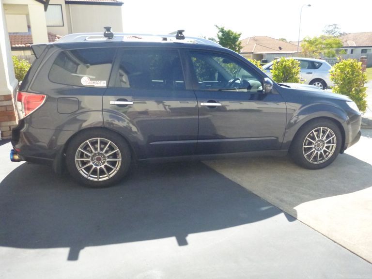

The height of my girl has been sorted courtesy of some help from Tein by way of the Street Advance coil overs (SH specific, so I'm not too low, but suitably lower than stock). At the same time as installing the coil overs, I upgraded the front stoppers to a set of Gen IV (05-08) LGTs (2 pots with 316 x 30 mm vented rotors). They're much bigger than the Foz fronts, and even with just OEM rotors and pads, provided quite a decent increase in stopping power. And at a very reasonable price.
Here are the LGT front brakes:
First pic of the new ride height (surprisingly, all that dirt didn't weigh the girl down too much):
Just a little cleaner:

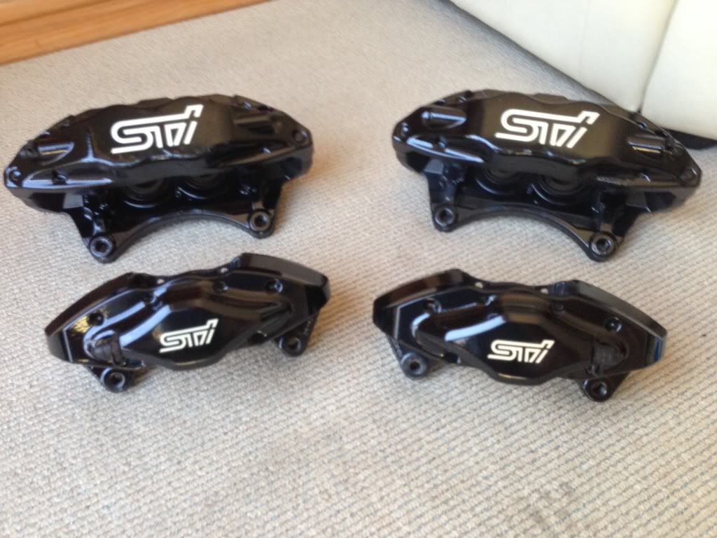

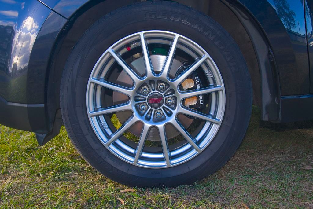

After a few beers one Friday night, I dove on some 08+ STi brembos that I found for sale on eBay. I'd been saving for a set of Stoptechs or something else slightly different, but when a full set of STi brembo calipers is just $1,500 delivered from Miami, FL, it's hard to justify the ~$3,000 for just a front set of Stoptechs...especially when they're about the same performance
The calipers I picked up were in pretty great condition, but one of the "STi" logos on the front caliper had started to wear a little, so I got the fronts rebuilt, sand-blasted and resprayed in glass black VHT caliper paint. New decals applied it's a done deal:
Even though I was completely content with the way my car was handling on the stock FSB and 19 mm Perrin RSB, I upgraded both anyway when I got a great deal on a Perrin 25 mm adj. FSB and a 22 mm RSB; Perrin, of course. So these, along with Perrin front end links (anyone seeing that Perrin-fettish evolving???), were installed; the FSB is set to soft setting (24 mm equivalent) and RSB is on hardest (22 mm). Because of a 45/55 F/R torque split, I didn't need the RSB to be stiffer like the 4EAT-equipped SH FXTs usually do to really make cornering neutral; with some potential for oversteer on occasion
I also picked up a pair of Invidia Ti twin tip mufflers to replace the Invidia single tip mufflers:
Because the stock 17 x 7" STi rims don't fit over brembos without spacers, I just "had" to get some new rims... I absolutely love the look of the 12-spoke STi rims (have done since the first "Tuned by STi" Legacy was released in Aus in about 2005), so I stuck with the same design, but in 18 x 8" from Japan Parts. They look fantastic! So much better than 17" rims:
17s:
18s:
Much better :biggrin:

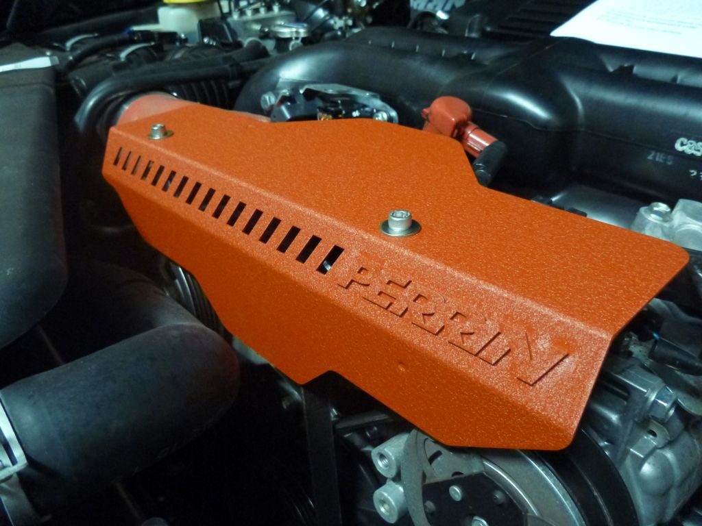

Somewhere in among all this, I've also installed a pulley shroud, yup, a Perrin one

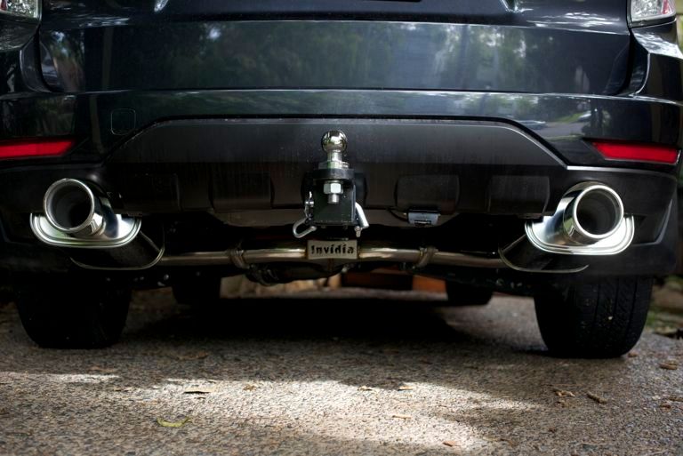

Doesn't look too bad I don't think, but I really do prefer the quad tip look.
Options are (for the moment):
Perrin:
Ultrex (just the diff/axle back/mufflers):
Megan Racing (again, just the diff back section)
I like the sound of the SPT system also, but it's design won't bolt up to the stock or STi mid pipes that I have. I also have the Invidia Q300 mid pipe section still which I could potentially use to bolt to some stock-type mufflers, with some modding...
I think I'm going to explore the Perrin or Ultrex options first as 1. I love Perrin gear, and 2. the Ultrex one is rather cheap (new)...
