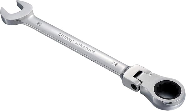

For the wrench maybe with one of these?
It should be a lot easier using the wrench on the O2 sensor but that upstream air/fuel sensor not as much. Still, I am encouraged by the fact you got yours out.
