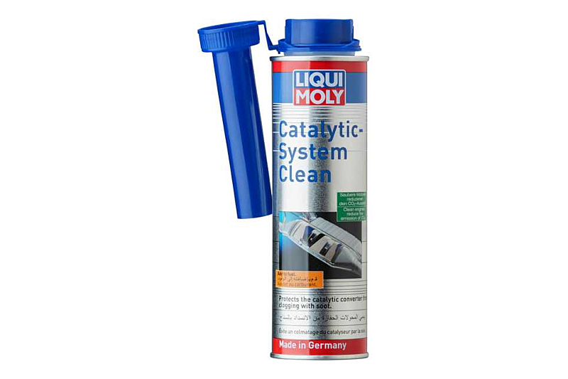

#5 ·
This is the best cat cleaner you can ever find. Give it a try
