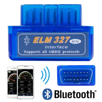

I purchased this one and cannot get it to work. Not sure if I know what I'm doing but the BT is ok, just flashes on ECU connections.
Tried a few tools on Android and iOS.
Did you get one that worked?
