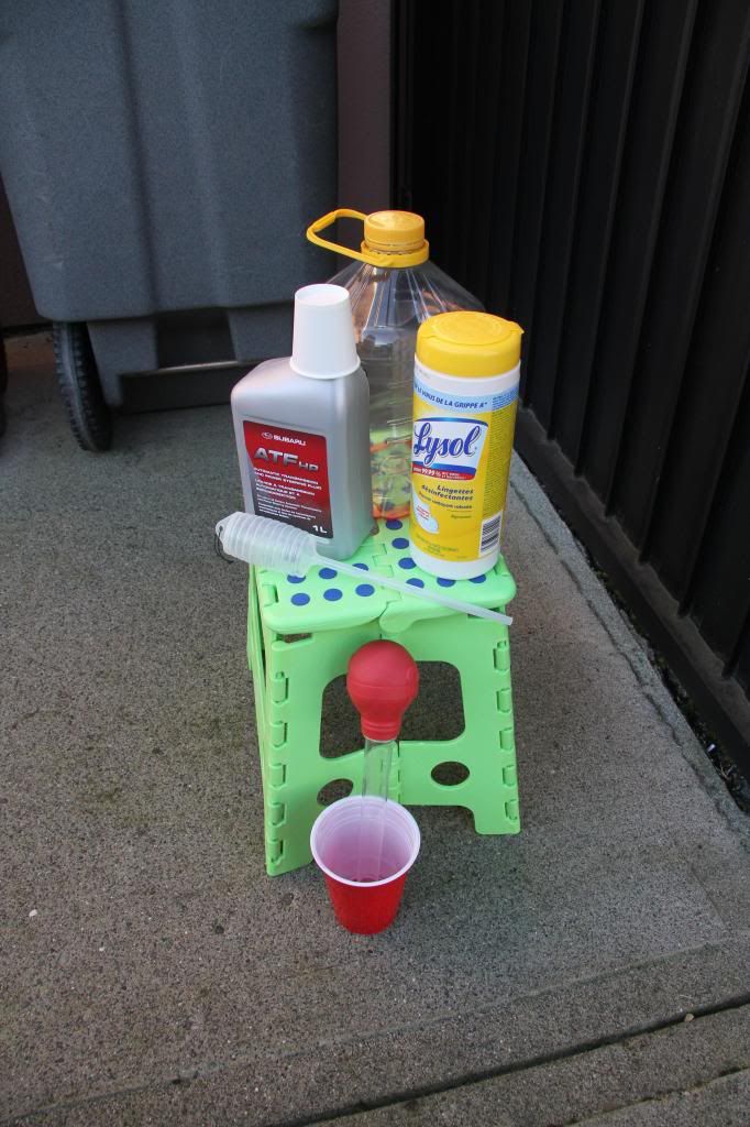

Here are all the things that I used for changing the power steering fluid.
a) 1 Quart of Subaru ATF-HP
b) empty container for waste oil
c) disposable cups
d) Pipette (bought from dollar store)
e) Turkey Baster
f) wet wipes (optional really)

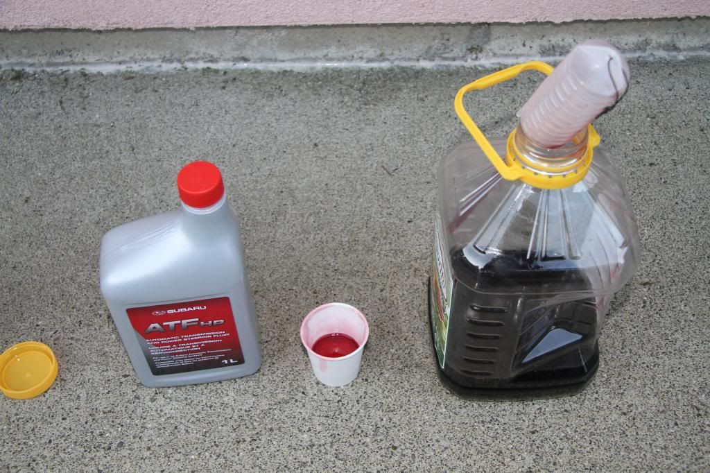

Here's the comparison.
The cup in the middle is the new ATF-HP in bright red, the container on the right is the waste oil I've extracted.
c) disposable cups
e) Turkey Baster
