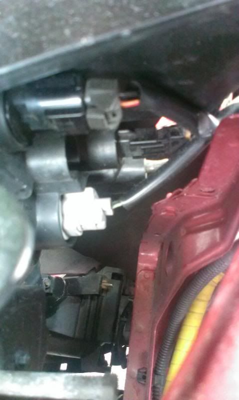

Does each plug end have a different color? If so, what are they? If they are the same as my 03, looking at the back of the passenger side assembly, big fat gray goes bottom left, black goes top right, yellowish(orange maybe?) goes bottom right. That's as much as I could see by peeling my fender liner back and using a flashlight.

Wow, I didn't expect you to go that far for me but thanks. I'll pull my headlights back out just in case. I was really hoping that someone could find any difference in functionality at some position or other. Starting to think it doesn't matter which bulb goes where. I bet I'll find out it does when I get everything back together :(
I'll pull my lights again and look. Thanks for going so far!

I just took a peek in my manual and flipped a page or two past the bulb chart/bulb replacing page and there was a drawing of the back of the assembly which shows three distinct plugs, their locations and their designations.
