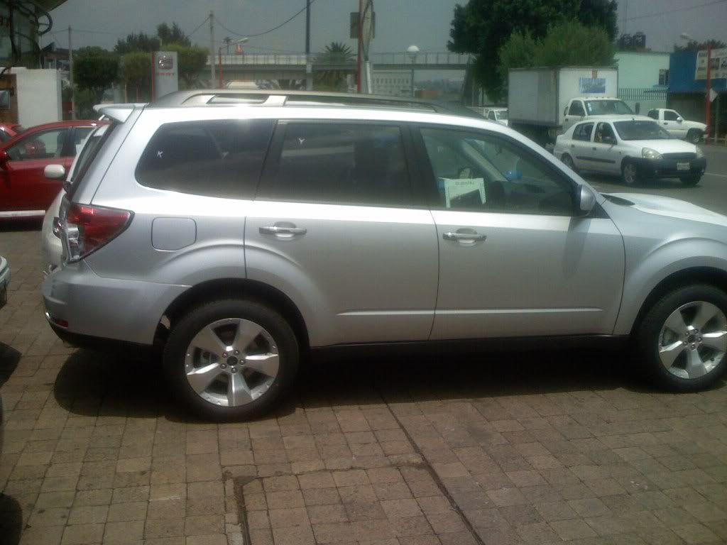

Well!! Really happy with the new Swift Springs!! I took some pictures to show how it looks!! Now, sway bars, and look for Koni replaments! I took pictures of the stock struts, hoping to get a Koni cartidrage!! BTW, sorry for the picture quality!! (Used the Iphone)
BEFORE!!
One day before delivery :woohoo:

NOW!!
Modded Front
Modded Rear
One more!
Well!! The driving improved!! I no longer feel the Crown Victoria driving style hehe!!
The lowering was not aggressive at all!! And as I said, I am just waiting to get a strut I can fit in.

To be honest, I think that 10 mm more of lowering over the Swifts could had been great!!
THE ONLY point I was able to check this last weekend, is that the front side is taller than the rear side, and I did everything that the instruction said!! (I am a all by the book guy)!!
The fron side has at least 10 mm more than the rear side!!! :huh: Looking at the instructions, it said that for WRX and STI you should cut one chump of the shock rubbers in order to get thing properly, but it did not mention anything about the Fozzy!! And considering that the springs were made for the Fozzy and Swift has the new Fozzy on its catalog, I did not consider necessary to cut one chump of the spring's rubber!! And btw, I do not think that the rubber could be involved on that difference of height!!
MMMM!! :shrug:
Thanks a lot!!!
#15 ·
The front will always look that way because of how the front fenders are cut compared to the rear fenders. The front fenders will always be cut bigger and have more gap because the front wheels need to turn whereas the rears do not. I can assure you that the car itself is level to the ground. I really made sure of this.
Glad people are enjoying them. Lots of care was taken into getting these springs right.
Thanks,
Gary
