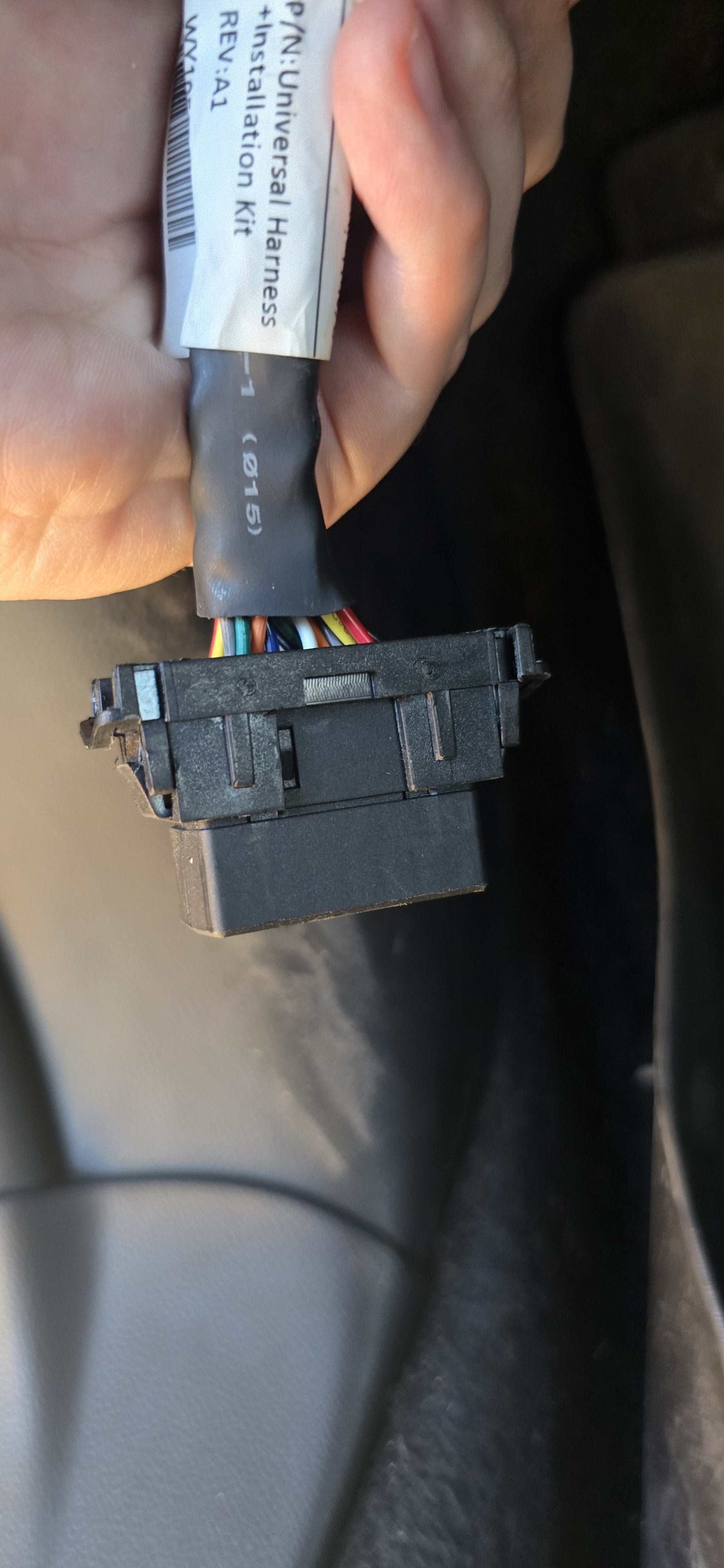

Forester sport 2021
This cord just fell out from under my dash, near the pedal area. From research it appears to be a OBD II adapter? Maybe? But it seems plugged into something? I dont know what it is or where it should go.
#4 ·
You can plug it back into the OBD port - the white port at the top right of your second image - if you want to maintain function of the LoJack/GPS tracker that was installed in the vehicle. If the vehicle was just purchased, chances are very high that it is powering a GPS tracker installed by the dealership where you purchased the vehicle.
#5 ·
Thank you for the informative replies! I bought the vehicle last February, and on my first service the mechanics said they found something spliced into the car, I'm guessing it was this device. I'll have to see if there's a way for me to access the tracking information, bc it would be nice to have that incase the car is ever stolen. But if not, I will be removing it.
