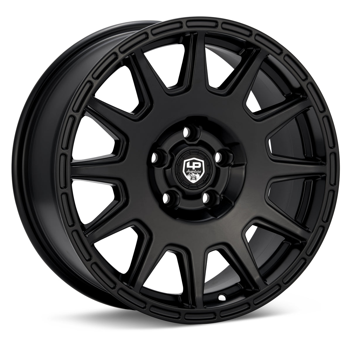

Already narrowing it down a bit, seems like closest to stock would be the wheels below and tire size 225/65/17. Can anyone confirm if they are running 225/65/17 on stock 2017 FXT suspension with any clearance issues?
