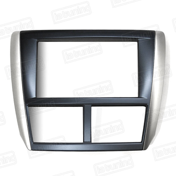

I then also bought a full replacement JDM dash bezel that fits the standard double din radio. This makes it look factory.
I didn't buy it from here, but this is what I'm talking about.
@RIPaXe Thanks mate. Wasn't especially cheap if I'm honest due to the custom harnesses which were $245 AUD. The fascia kit was $37 and the head unit you can pick up for about $350 at the moment. Obviously I did all the installation which cut out that cost.

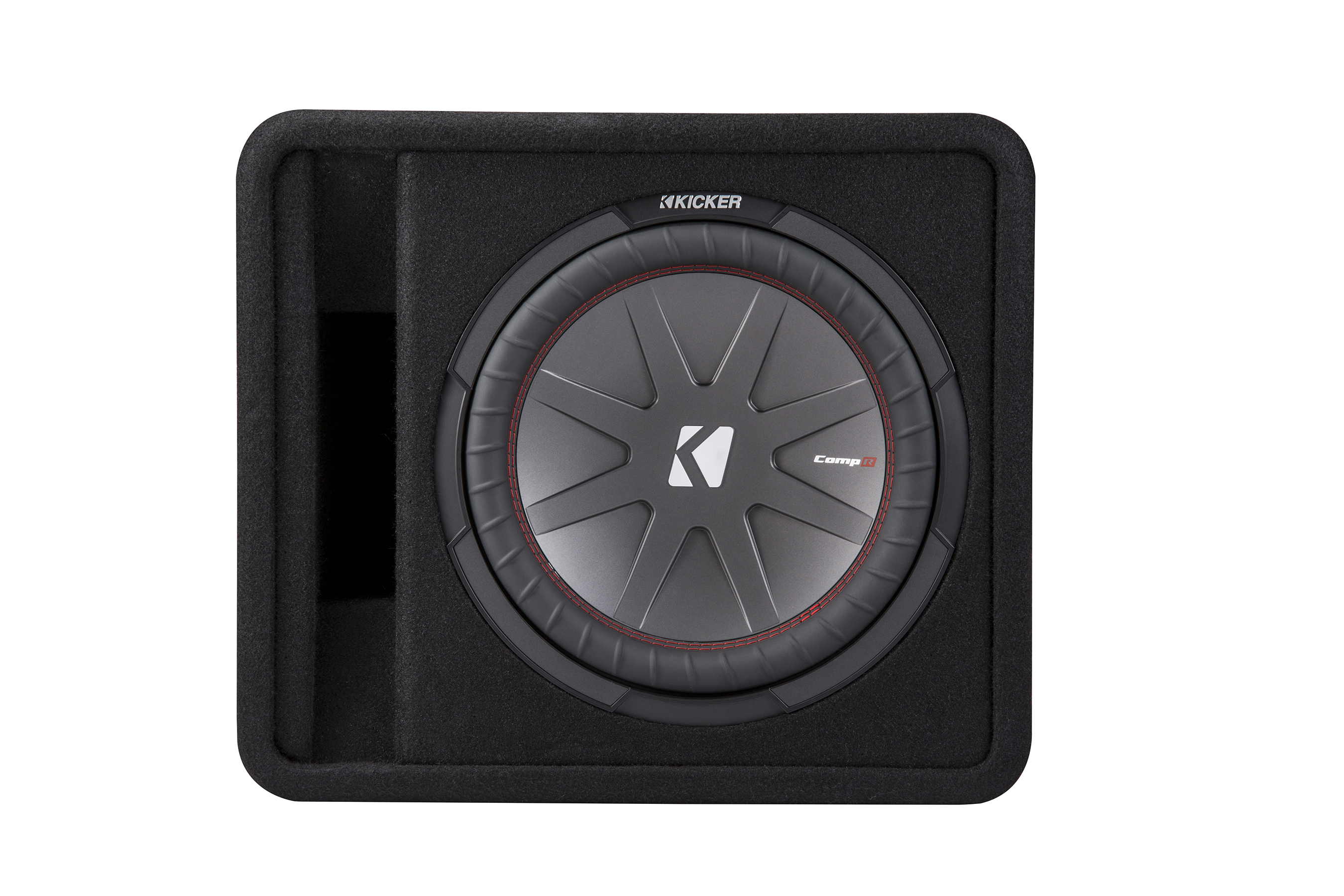

For me, it's an easy expense to justify because it improves the driving experience so much with maps and general usability. Listening to music in the car is also a big deal for me and this improves that experience so much more as well. Since writing the above post I have installed an additional Alpine 5-channel amplifier and 12" Kicker sub. It's sounding verrrry nice!

I retained the factory amp and run the four tweeters out of that. I then installed the 5 channel amp under the rear portion of the front passenger seat. It slightly encroaches on the rear left passenger foot well but it's pretty well obscured by the floor mat + my car is rarely full of passengers so not a problem for me. I re-wired the four woofers + run the sub-woofer through the new 5-channel amp. Yes, I did run new power to the battery and all cabling under the car's panels. It's all tuned and sounding really good!
