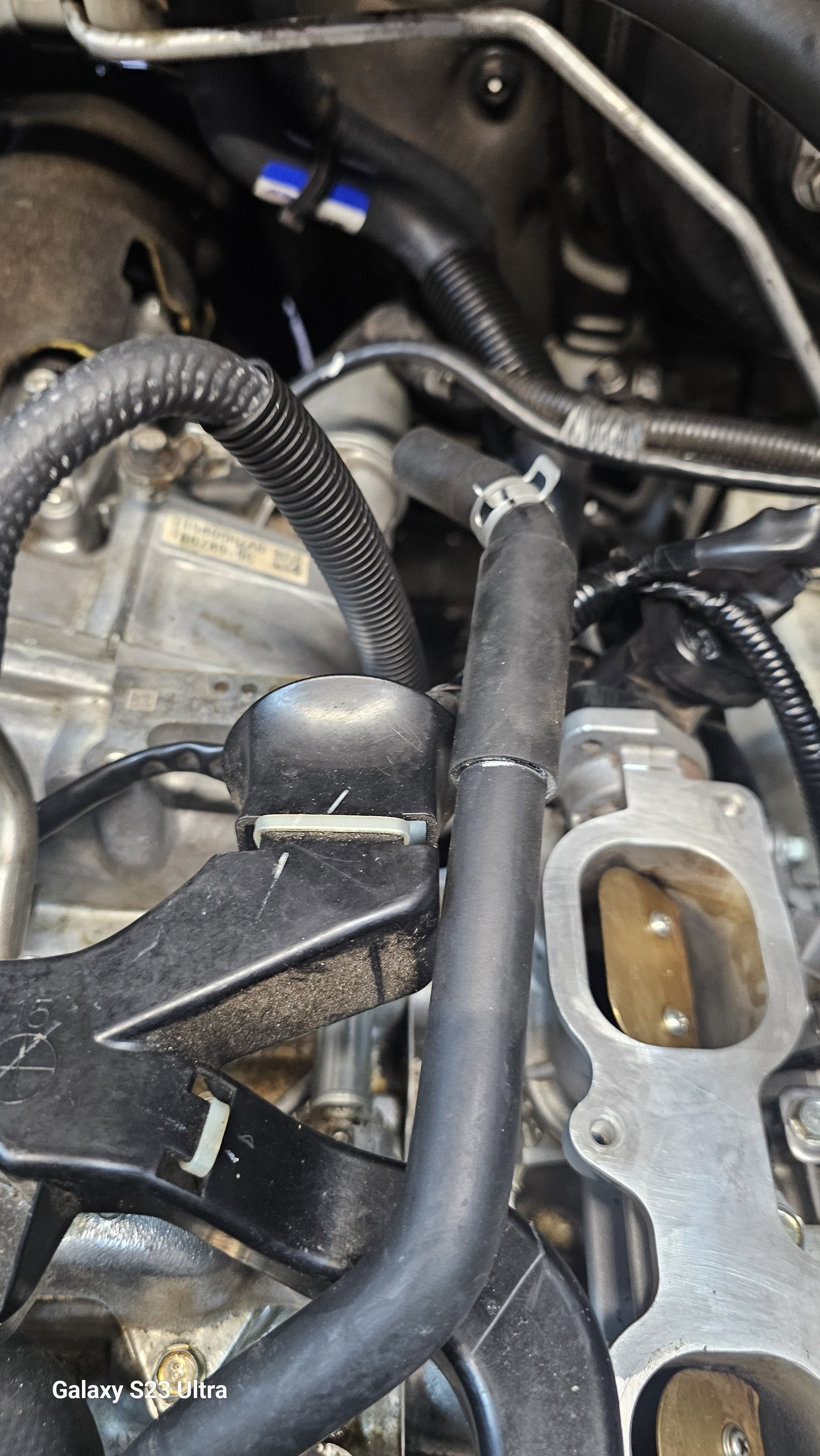

My 2015 Forester 2.5L renewal project hit a snag; I hope you can help me. The PCV Connector Hose B. I know it routes from the connector over the top of the driver side of the engine. I can not recall what it connects to. Your help would be appreciated.

Hey, I'd be happy to help you figure out where that PCV Connector Hose B goes! From what I recall, it should connect to the intake manifold or possibly the valve cover. Do you see any labels or markings on the hose or nearby components that might give us a hint? Maybe we can troubleshoot together and get your Forester up and running again!
#7 ·
I thought that might be, but the throttle body barb is 1/8ID" and this hose is 1/2ID". The Heater hose collent pipe has a pigtail pipe/hose to the driver's side of the TB.
#6 ·
So it sounds like the PCV connector hose might be a bit more tricky to track down. Can you check the other side of the intake system or maybe consult a repair manual specific to your Forester's model year? Sometimes those diagrams can help pinpoint where a part might be supposed to connect.
MYManual shows connect Hose B, but then refers to FIG.073 which I have not found.
