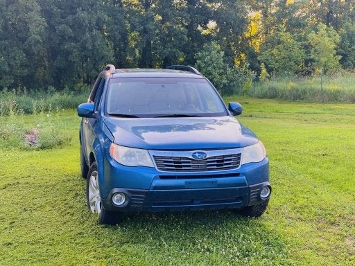

Vehicle Details:
X Limited
Transmission:
4EAT
I just replaced the manifold gaskets and manifold to downpipe gasket on my 2010 subaru forester, I have had really loud starts from a cold start state since I got the car but it god really bad until I repaced the gaskets. It is a bit more quiet now and I dont smell any fuel or carbon monoxide, also just did cylinder #2 spark plug since it had a repeated misfire (I am waiting until it happens again then Im calling it an ignition coil issue but it is good as of now) and that has somewhat helped my car's rattle. I have a PZEV and I have seen from research that they start loud and high to heat up the cats faster. It does seem to be loud then die down as if it is heating something up.
Is this just a normal thing with PZEV models or is this possibly a manifold issue under the heat shields? And cause for concern?
