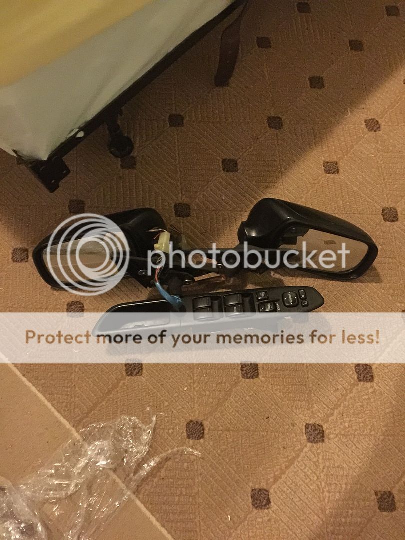

You will need a set like this, it's what I used and know how to wire.

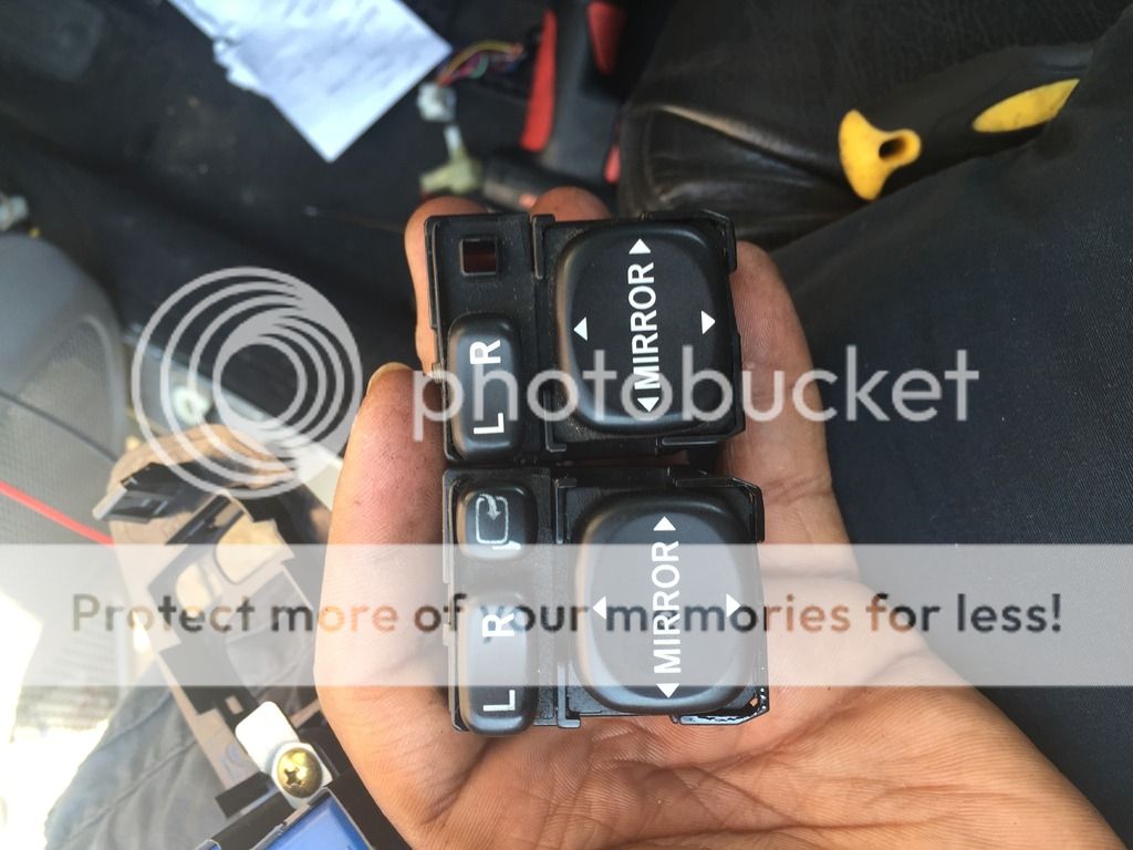

The switch is included with all the other window buttons, the switch will be taken out of the JDM control pod thingy.
Next, you will notice that the pigtails on the JDM mirrors are cut. You need to remove these two pins and repin your stock harness in your door. No picture but the wires I'm referring to are blk/white and solid yellow.
Next, unplug the harness to the switch that controls the mirrors on the JDM control pod thingy :) compare to your stock harness and you'll see the JDM harness has two extra wires. Remove those two extra pins and repin your stock harness. These wires are also blk/white and solid yellow. See pic below.

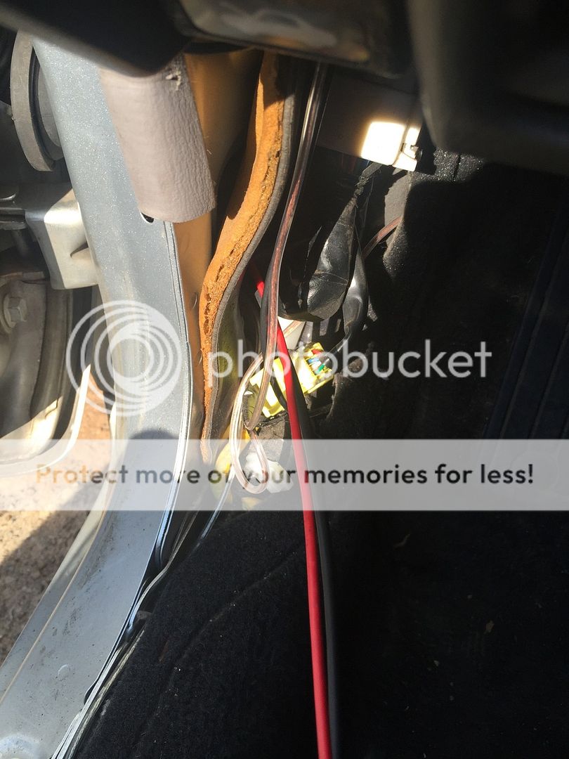

So, the next step is removing the mirror control switches from both main control pods. From here, I added a length of wire for power and ground from the newly pinned door harness all the way to the passenger side. Basically connecting both female harnesses. I took the time to solder and run the wires through the loom in the door jamb, under the carpet and dash, under carpet again and back through the passenger door jamb.

At this point, I did the same thing I did on the driver side. Repin the harness from your door to replicate the JDM harness that came with the mirrors. Connect the wires you just ran with the two new pins on your harness.
Install passenger mirror and button up your door panel.
Go back to your driver side and tap into your power and ground wire and splice the two wires you pinned into the mirror control/fold harness. This will now suppl power and ground to both mirrors. See what I did there? Made it easy!

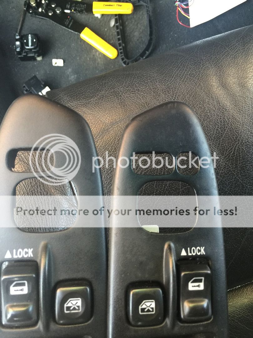

The last thing is to retro fit the folding switch into your usdm main control pod. *****DO NOT USE THE JDM CONTROL POD*****
I took a drill bit, made a pilot hole and quickly made it bigger. Slow down and don't ruin it, it'll be your fault.
Save

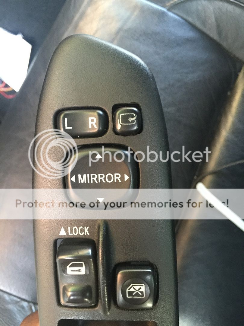

Below you will see the usdm and JDM bezels.
Make yours look like the JDM pod!
I used a dremel to achieve that.
Here's the end result below.
