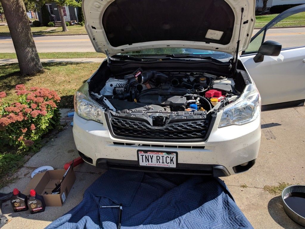

5. Refilling the transmission fluid is what took me the longest because I couldn't find the tranny fluid dipstick... It's under the hood, behind the air intake, passenger side, hidden behind a wiring harness. Here are some pictures to help you find it. Note that I took off the air intake pipe for easy access (that's what we'll call it for now):
[IMG][/IMG]
[IMG][/IMG]
[IMG][/IMG]
I put 3 full bottles of gear oil + 150 mL (manual says 3.3quarts).

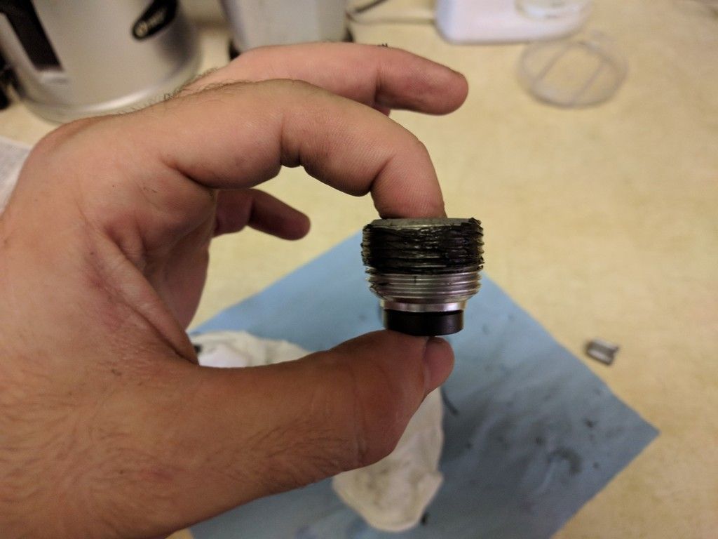

Wipe metal shavings off from the magnet and get all the liquid gasket that was previously applied outta there. I used a tooth pick. Here are before and after pics:

8. Reapply liquid gasket to plugs.
[IMG][/IMG]
9. Put the drain plug back on and torque it down. Be careful not to get the liquid gasket everywhere.
