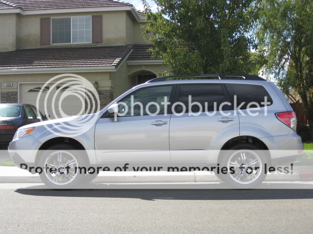

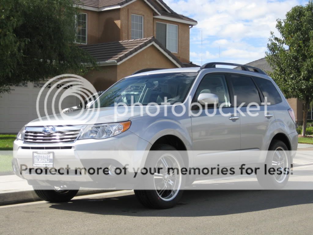

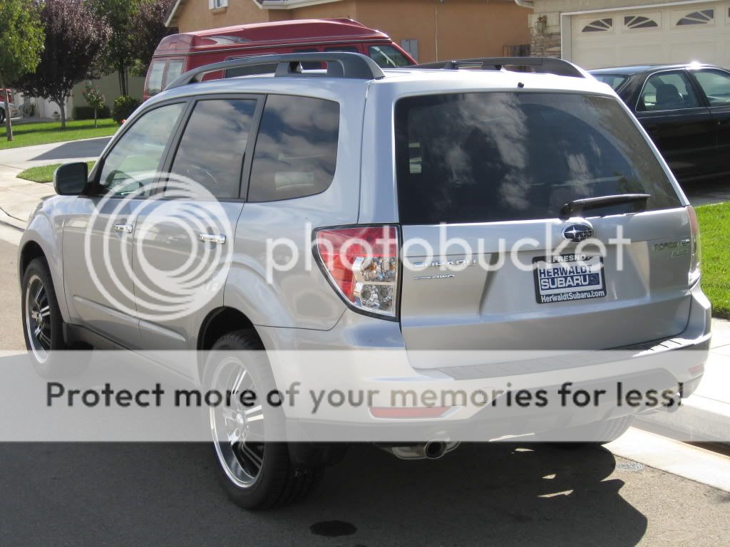

I just bought a 2010 Forester and currently have 235/50R18 tires on it. I was wondering if anyone out there Knew if a 245/45R18 would fit in the car without any suspension changes and would also have no rubbing with 5 adults riding in it to go to the mountains. thanks
Here are some pics of the forester with my wheels on it:
