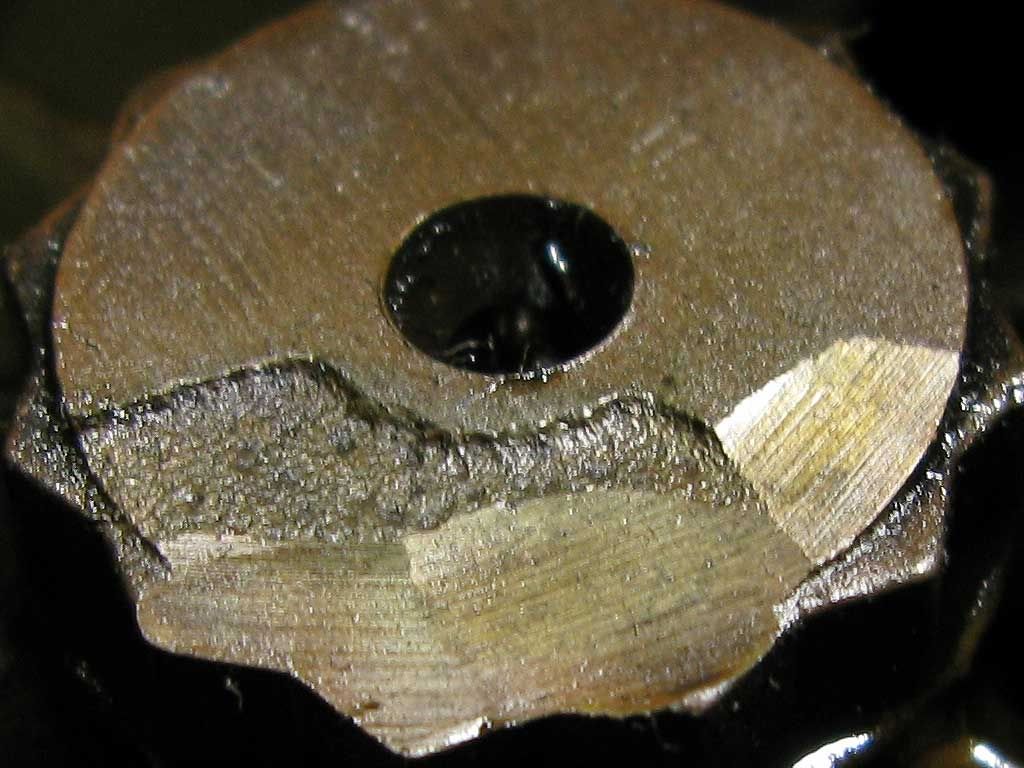

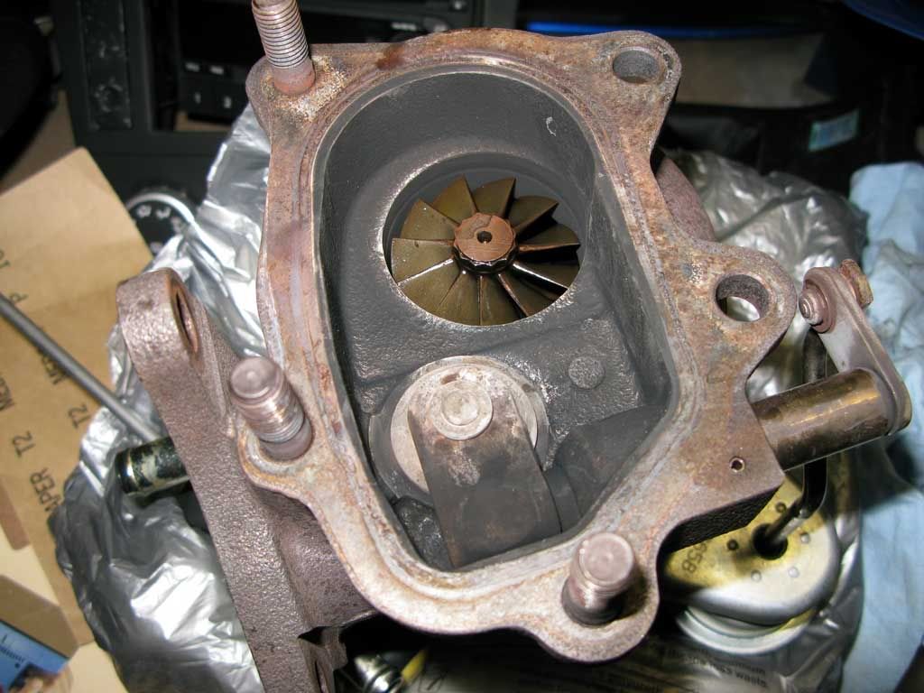

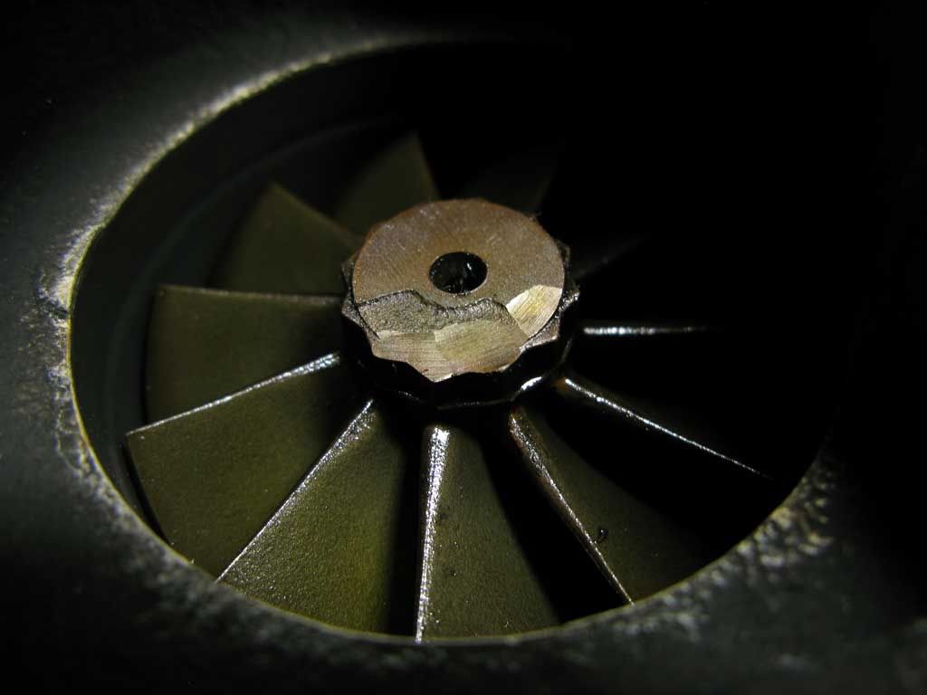

I just picked up my VF48 today, looking at the wheel on the exhaust side it looks like its there's metal flaked off.
At first I was a bit concerned but after doing a quick search I see other VF48's look the same way like this one below. So, why did they make it look like that ?
29,450 Posts
That's to balance the turbine wheel.
2005 Base 2.5x foz
896 Posts
Exactly. Balance, also why they all have it but it's not the same on every one.
07 Forester XT
6,759 Posts
Discussion Starter #6
Good to hear thanks ! Don't know jack about turbos so I was wondering if it was damaged.
