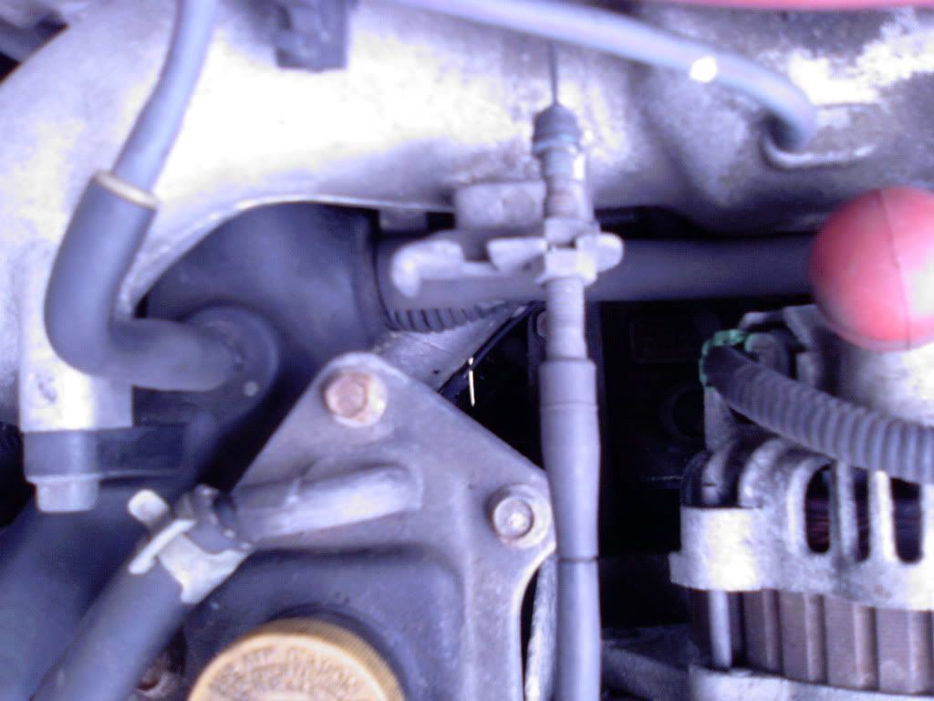

There is an oil leak somewhere and its pooling just below the power steering refill point. I seem to remember there was a bit of oil on the drivers side of the engine from when I changed the plugs so it may have been leaking for a while. But I haven't seen it pooling before so maybe its getting worse :confused:
Last time I checked oil level a few weeks ago it was full and now its about half way between the dots. Again any ideas welcome but I may have to pay a visit to Godalming.

the oil is probably a cam cover gasket , very common .
