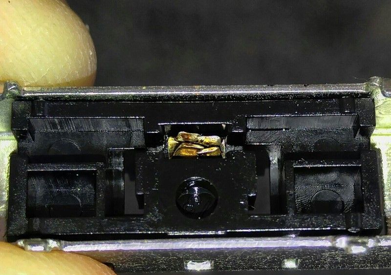

My dome light stopped working so I took it apart yesterday. Subaru decided to use a very low quality switch. The copper piece that is used to make connection is a very thin, soft and brittle, almost like aluminum foil. Looks like it tore from use. I bypassed the the switch so atleast the light will work when a door is opened. Called the dealer and had to order a whole new fixture, the switch alone can't be replaced.
