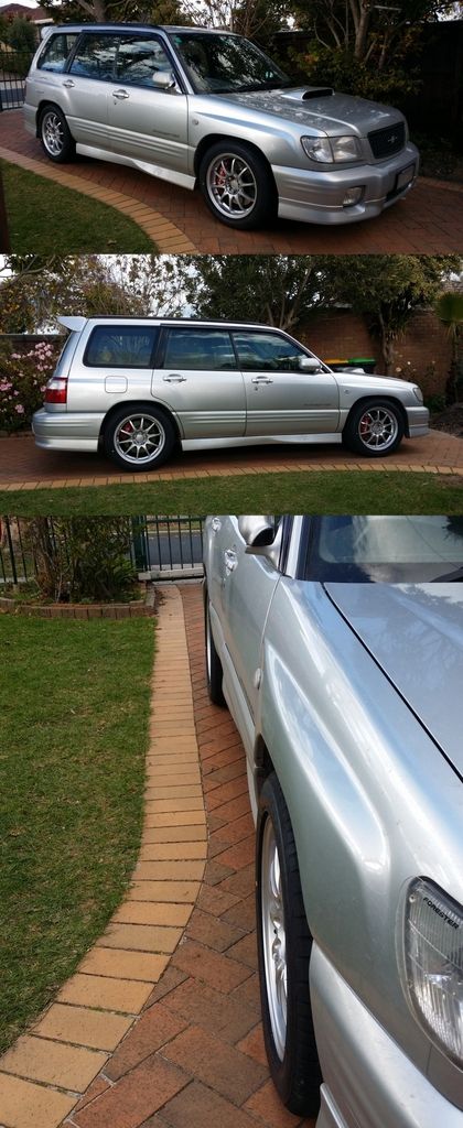

Hi All,
Below are some pics and specs of my SF5 GT that has slowly been transformed from a complete boat to a capable tarmac bundle of fun.
waali's GT Picture Index: Full ozfoz.com gallery index at the end of this post
Modification list after photos below, scroll down.
Specs:
