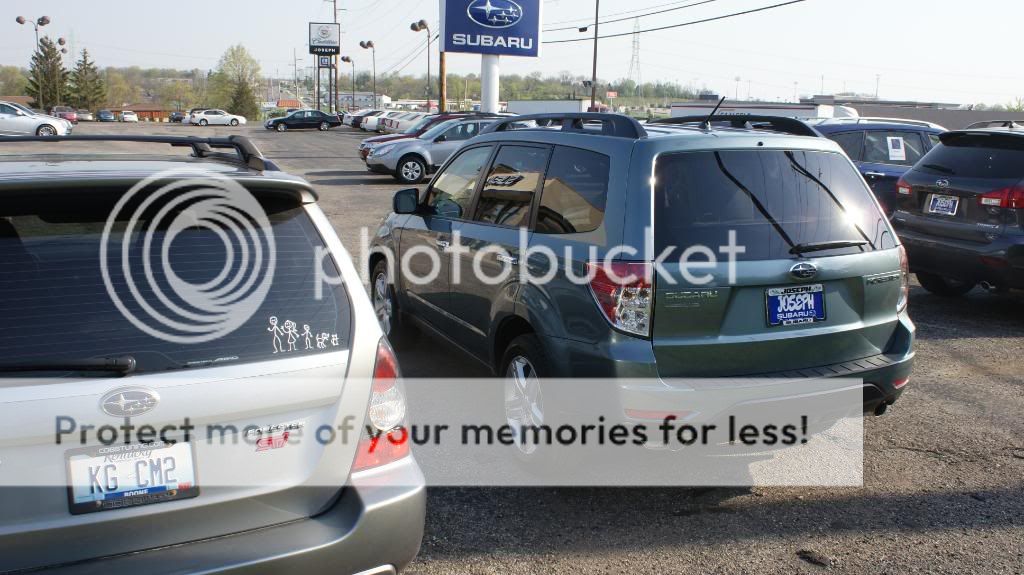

Here are the photos on the Dealership lot parked next to the FSXT.
