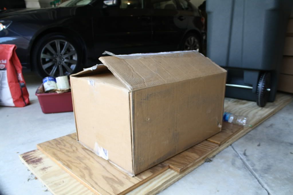

I can has mystery box?
^^ More! Must have more pictures! :icon_eek:
Suprised nobody noticed the new Rex in the background... it was my detail job for the day. My stepmom came home, and had a cow when I told her that I traded the Outback (it was parked somewhere else). +1 for mildly amusing practical jokes.

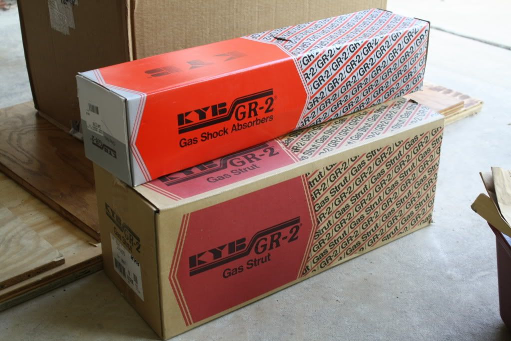

Anywho, another package arrived today, so I can share a pic or two of my new corner-carving, load hauling goodies.
They go on next Monday morning at Sheehy. I'm so excited! The ones on it now are original, with 138,000 miles of city potholes on them. I can't wait to feel the difference. :woohoo:
One thing... I need someone to reccomend me some good alignment specs. I want a setup that is reasonably fun through the twisties, but won't kill my tires. I know some of you here love auto-x and breathe this kind of stuff, so please, speak up! I don't have much time!
zero toe
-1½ to 2° -front camber
-1 to 1½° -rear camber
Gr-2's are nice... I have a set on my Forester
My bank account is now dry. :lol: Hopefully the springs will help cure my saggy butt syndrome. Supposedly if you get the RalliTek RSB to go with the HD rear springs (in the pic) it makes the car handle like a dream.
Thanks for the specs, Duder... I'll add those to my instruction sheet for the mechanic.

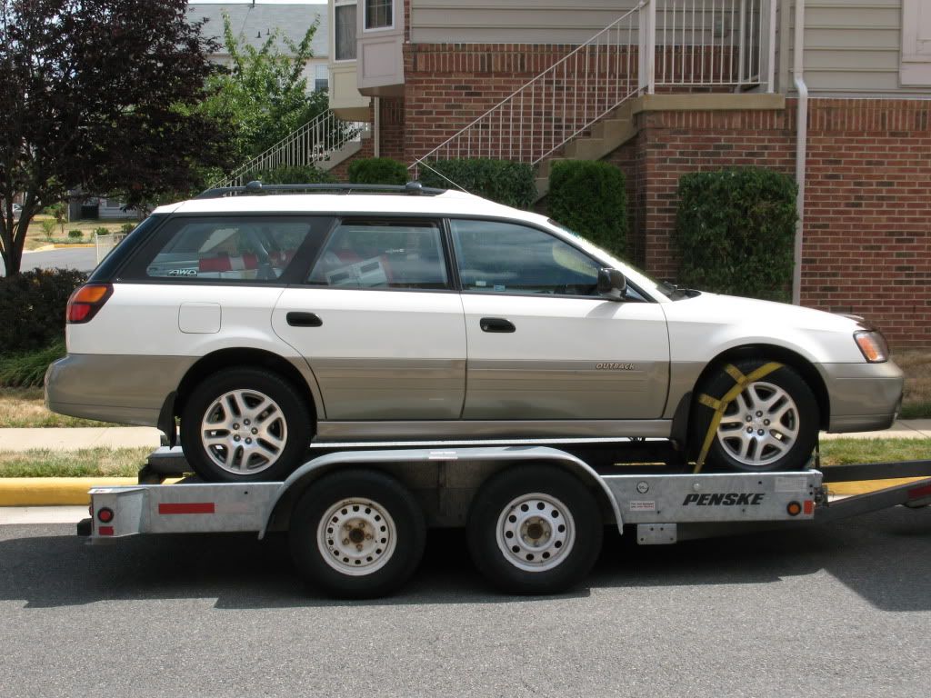

Got my new suspension put in! Took them a whopping three days due to some rusted rear control arm bolts (which eventually had to be cut with a torch). Got new rear control arms for free since they melted the bushings in the process.
The ride is FIRM, like a stock Fozzy setup, but stiffer. It corners better than the Foz now, too. So, it's fun... and it's practical.
Playing trailer queen, loaded with about 600lbs of stuff in the back during the move to North Carolina. I said good-bye to the car yesterday, I'll get it back in October once they finish using it to help move stuff around. NO SAGGY BUTT! :biggrin:
