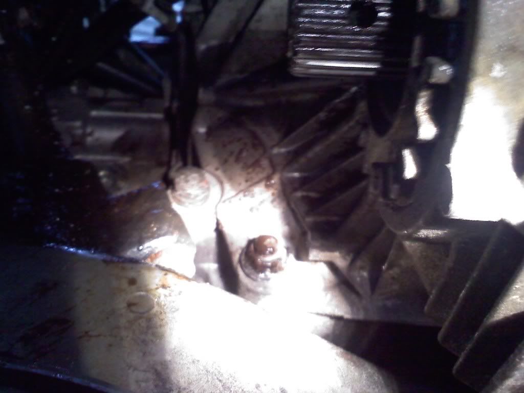

Well, we're getting there. Who has a suggestion on the best way to remove these left lower trans bolts? I spat and cursed at them, and removed the CV shaft (since I'm replacing it anyway) but I couldn't get them out before clean-up time.
