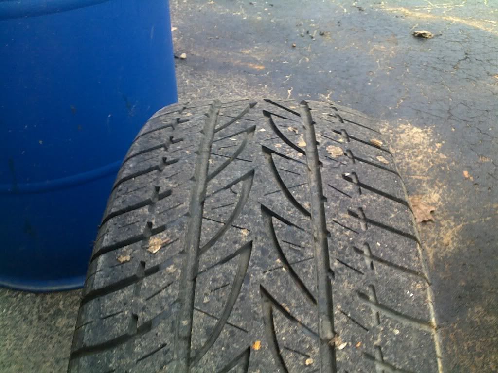

Changed the oil and rotated the tires today. The Purolator PL14610 fit perfectly, and cleared my headers fine.
Holy camber wear, Batman! :lol: (cell pic)
^^ You did say you were looking for new tires! :wink:
