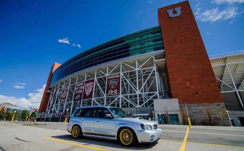

1,742 Posts
Removed a stock 5 speed... currently has:
-2005 STI 6-speed transmission and rear diff
-STI drive line
-Complete 5x114 hub/axle/knuckle etc swap
-STI trans mount
-SouthBend stage 2 "daily" clutch
-ACT Streetlite Flywheel
-Goodridge Stainless clutch line
-DCCD Pro Universal controller
-Kartboy SS + bushing combo
-Group N trans mount
-Kartboy trans mount bushings
-Beatrush Pitch Stopper
-TIC rear diff mount bushings
-Kartboy outrigger bushings
-05-07 STI Spec Tein SS-P coilovers
-Front Subframe spacer removed.*
-2005 STI steering rack
-Whiteline steering rack bushings
-STI Lower Arm Bar
-STI Aluminum Front Control Arms (w/ free caster mod)
-Whiteline ALK
-Whiteline RCA
-STI Aluminum Lateral Links w/ Group N bushings
-Front COBB 25mm Swaybar
-Rear COBB 25mm Adjustable Swaybar
-Whiteline Rear Subframe Lockdown Bolts
-COBB Swaybar Mounts
-Kartboy Solid Front and Rear Endlinks
-Cusco Type 40 rear strut bar
-STI Titanium front strut bar
-GD Impreza rear subframe
-GD Impreza diff carrier
