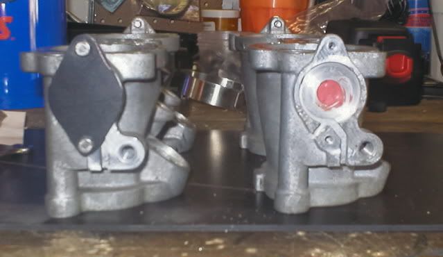

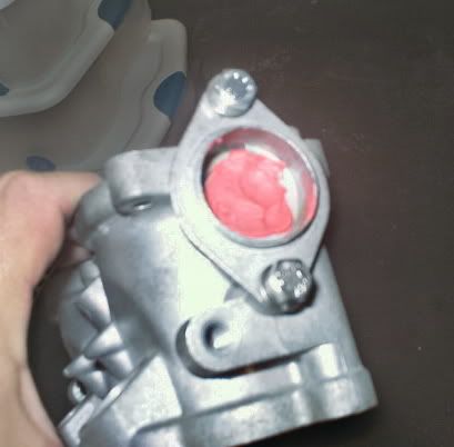

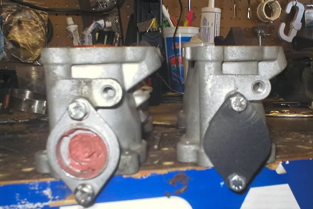

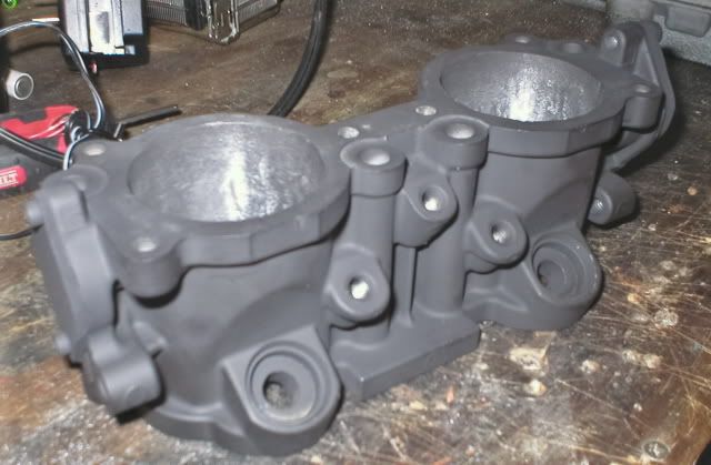

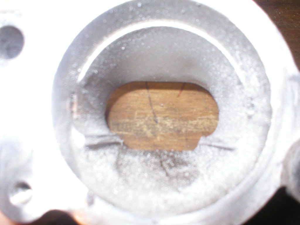

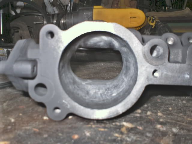

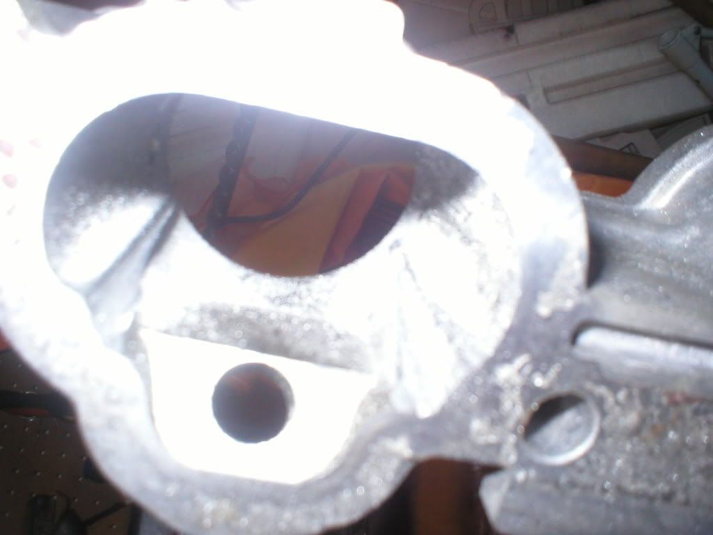

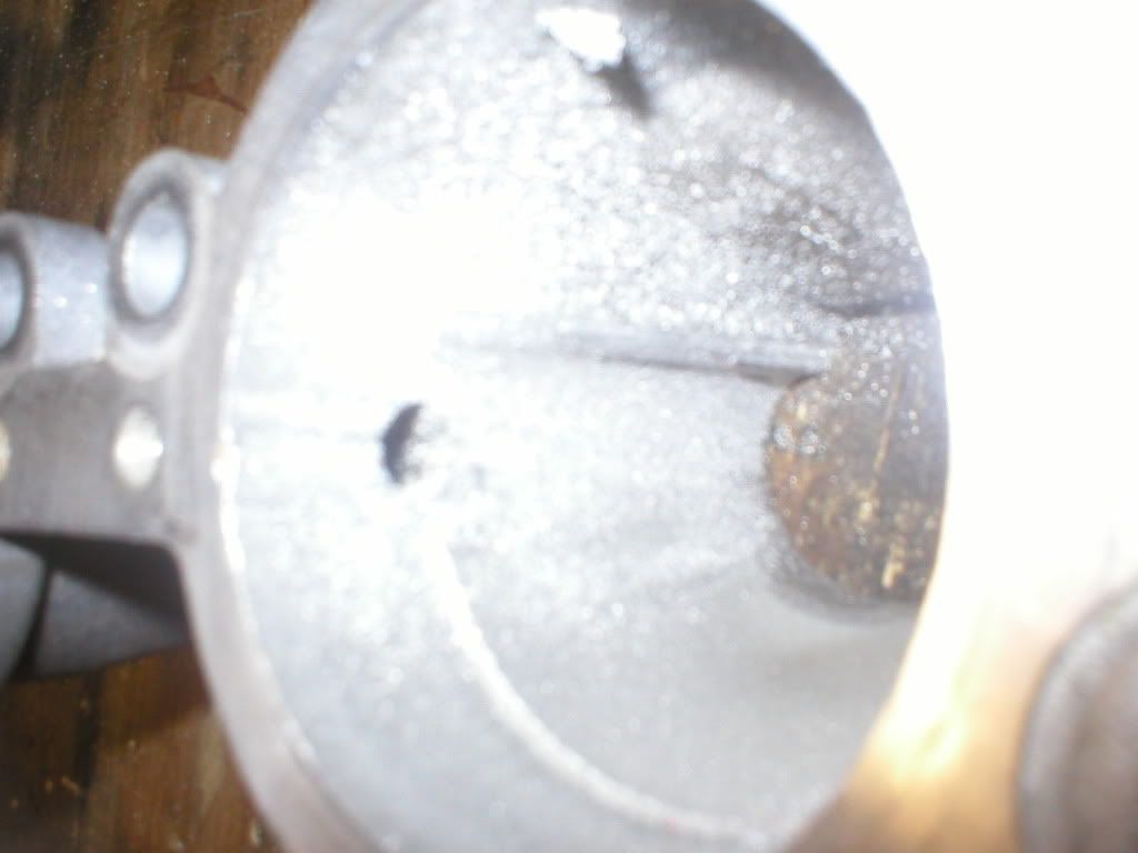

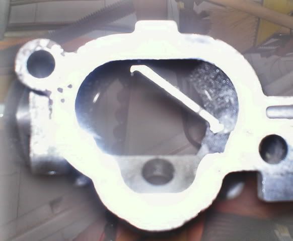

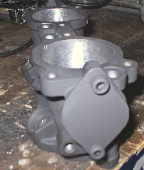

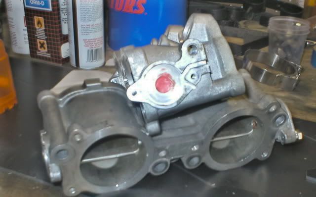

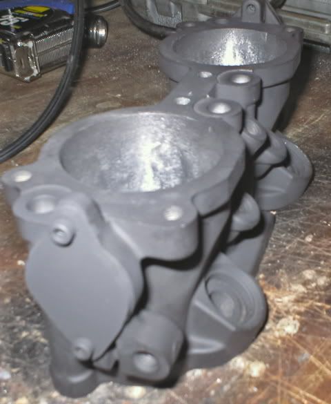

I cant leave well enough alone. I bought these with the bolt/JB weld mod w/o rods/butterflies. I took them to Real Street Performance and they welded the holes so I could cut out the divider and port/polish them. A hacksaw did the job with the divider quite easily and the Dewalt with a grinding stone did the rest. I fabbed up some covers for where the motors were as I really liked the KSTech caps. I will update with install after I get the Phenolic spacers, injectors and turbo inlet in my hands. Oh, VHT paint also with a plan to VHT the whole manny when it is out for install.
