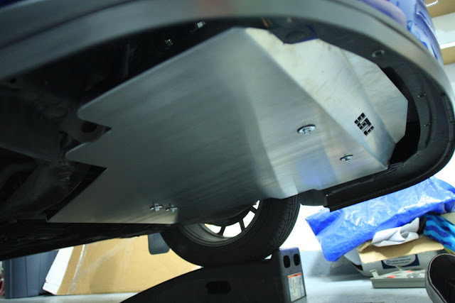

Today I put on my Subtle light duty skid plate. "Light duty" is kind of an understatement though. This thing is tough, and I especially love how it fits the contour of the the undercarriage, even up to the front lip. I'd say there's about a half inch of clearance between the plate and my fumoto oil drain valve.
Here's a couple pics

So you're going to have to take that thing off every time you change oil?
That seems a bit of a PITA.
Looks good though.
If they made one with an oil access hatch, I'd be all over it.

Nice!! I love mine, and the fact that it serves the purpose of adding an aerodynamic aspect to the underbody.
Of course clearing the fumoto and STI lower arm bar, is a plus too...
Props to Subtle-Solutions, and looking forward to future products...:biggrin:

Oil changes shouldn't be that bad. There are only 4 bolts instead of 6-7 plastic ones. Plus, I like how it will enable me to check my exhaust manifold bolts to see if they have backed out at all, since I hear they back out often when another manifold is put in.

My next thought about this item is aerodynamic aspect to the underbody to reduce air drag, which plagues the forester. I have been doing some research about air motion in underbody paneling. I read that this was cut on water jet and done in cad. Are the sides stepped back like that for a reason or is it just to clear moving objects. The STI lower arm bar if you were to use the 3/16 5052 and extended the skid to the mounting location would/could make for an even greater brace with just the skid plate. The next thought is what about a skid plate/aerodynamic underbody panel which utilized a lot of the empty voids between the body and lower object in the car to a rear air diffuser. This would need to be out 1/8 for its size one 4x8 sheet would be enough I think to make some thing to help aerodynamics and wind flow for under the car and maybe produce a little down force? It would have to be about four to five different shapes, which would be removable as it's own independent panel. It would be a cool add on but I think that the benefits would be worth it; this would be a lot of time with a water jet and cad to make some that worked with all the moving parts under the car. Maybe I need to go to bed and just deal with the flying brick theory.

The plate is an 1/8" in thickness and it weighs approx. 18 lbs.

Website says 1/8" is 28 lbs. That's quite a bit of added weight, especially to the front.
I really like the piece, but you should always consider the weight/benefit ratio of anything you add to the car.

28 lbs is for a 48" x 48" sheet, not the skid plate itself.
Weight Comparison (raw sheet form):
* The following should help explain the weight difference between (.090" - 3/16") thick 5052 Aluminum.
* These sizes are for comparions purposes only. They do not reflect the actual weights of the CNC water jet skid/aero plates.
Qty = 1 48" x 48" piece of .090" (3/32") Thick 5052 grade Aluminum weighs => 20.8 LBS
Qty = 1 48" x 48" piece of .125" (1/8") Thick 5052 grade Aluminum weighs => 28.8 LBS
Qty = 1 48" x 48" piece of .1875" (3/16") Thick 5052 grade Aluminum weighs => 43.36 LBS
