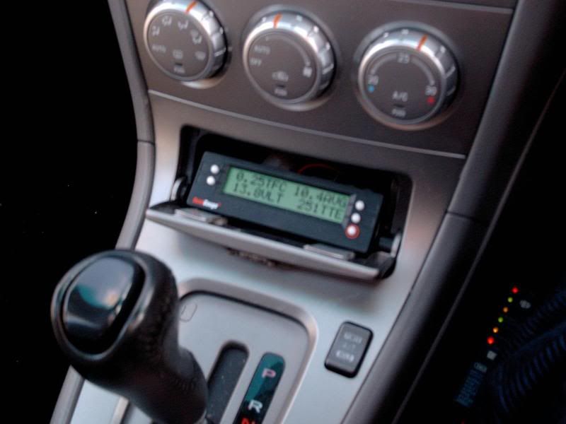

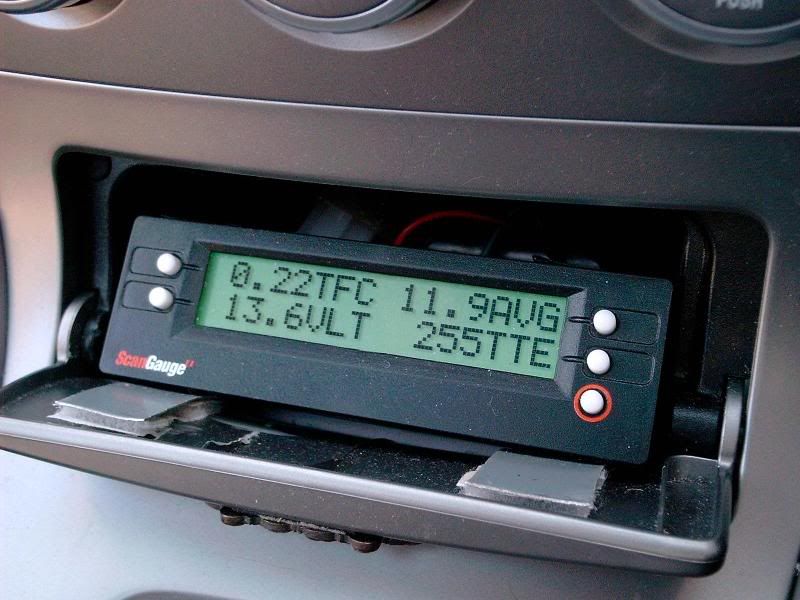

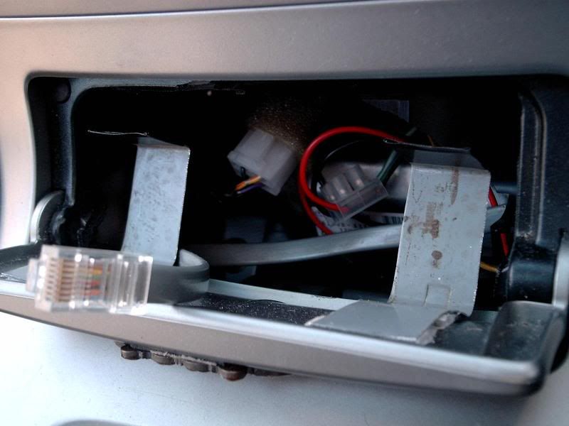

The Scangauge is just an ideal size for the ashtray opening. I cut away everything from the rear apart from the bits needed for the hinge mechanism. I then stuck some aluminium brackets on the inside of the lid which were bent to fit the Scangauge. Next I made up a short length of flat flexible network cable, the cable with the gauge is too stiff to fold and unfold with the lid movement. The ciggy lighter was moved to the side pocket. Job done.
I just need to find some black material to cover the wiring at the back.

Nice job. I've sometimes thought about getting one of those - do you find it useful?
And out of curiousity what's the row of coloured LEDs on the right side of the console?

In answer to the last two posts the Scangauge reads and cancels error codes with no problem. That was one of the reasons I bought it, on the "improved" 06 model error codes set numerous dash lights flashing and disable the criuse. Very annoying when you are about to embark on a long journey at night. At least I can now hopefully cancel if the dreaded secondary air injection fault raises its ugly head again.
I have found the more mundane gauges the most useful, volts and miles to tank empty. Also the total fuel cost for the journey is quite useful if someone else is paying for the petrol. :biggrin:
The LEDs are a voltage read out for the battery, which I don't actually need now.

Where does the other end of the cable connect to? Does the OBD port accomodate a LAN/data cable or an adaptor is required? I'm really interested as this something I would do next payday!

one end of the cable connect to car ODBII port (under the steering wheel) and the other end connect to the scan-gauge port. So no adaptor needed it all inc in the box :biggrin:
[/url]
Sorry major, if you want the scangauge in the ashtray with a working lid you do need to extend with a piece of flat flexible cat5 cable. The connection at the scangauge end is an ordinary network plug so you need a cat5 straight coupling. If you don't want the ashtray door to close then the cable as supplied is fine.

Does anybody know if a thin, flexible ethernet cable (much thinner than the one in the ashtray installation picture) will work?
The bulky, rigid cable that comes with the Scangauge E makes clean installation almost impossible.
