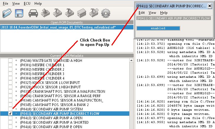

Bing/Google searches brought me to this thread whilst on my quest to figure out how to change state of DTC trouble codes with EcuFlash. I offer the following as a means of paying forward the benefit I received from the work of those who went before me.
open the rom in ecuflash, once opened scroll down to the trouble code you want to disabled and click the check box. A windows will appear saying whether enabled/disabled. click the value then go to edit bar and use increase or decrease and that will change value. The description of item you have changed in rommetadata pane will turn pink to show that value has been altered.
Like andycook and others, I also had trouble determining how use EcuFlash to change a DTC P-code from Enabled to Disabled. Like them, I resorted to using EcuFlash to read/flash the ECU, and RomRaider to edit the state of the DTC codes.
OpenECU & RomRaider sites have a LOT of helpful information, but speaking for myself, no clear directions about changing DTC codes in EcuFlash were uncovered.
While posts about the subject appeared in several forums, making it evident that others HAD changed state using EcuFlash, their skimpy descriptions left the impression that it was done with a radio button or a drop-down pick list, not from the DD menu. As a noob, I was certainly reluctant to dabble.
Euan's directions above were the best of the lot I encountered. I thank him for showing me how to move forward in EcuFlash.
But.
I believe Euan should have written "use INCREMENT or DECREMENT". This is because changes made with those menu choices are reversible.
In contrast, if I use Increase or Decrease in my instance of EcuFlash, "Enabled" will change to "Disabled" - but the changes made with these menu choices are NOT reversible. The state of the DTC can not be flipped/restored back to the original condition of "Enabled".
Some pictures:
First:
Next:
Now:
Finally:
