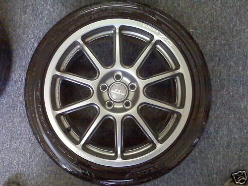

New mods waiting for install:
-OEM gauge pack housing*
-OZ 17"x7" wheels
