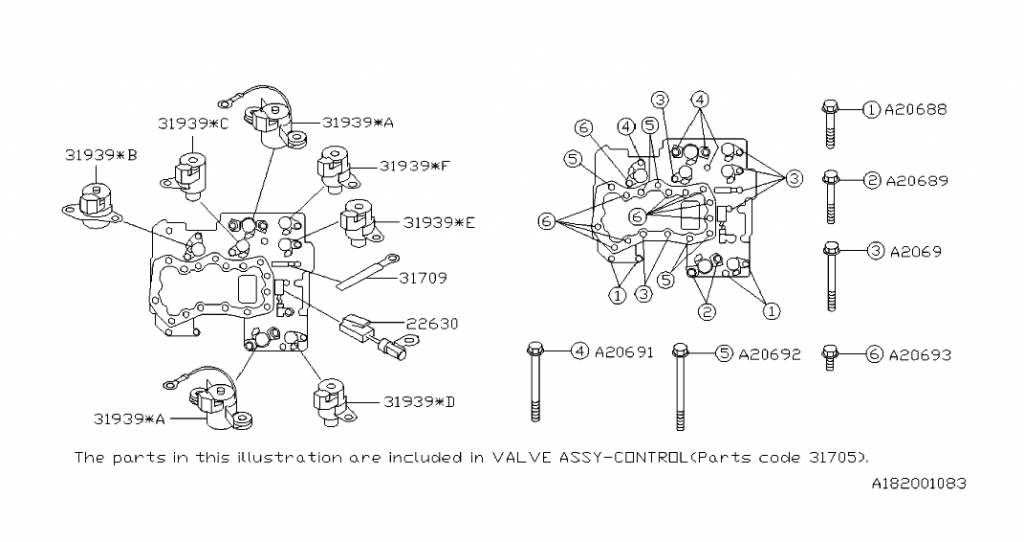

So I got a hold of my trusted dealer looking for transmission solenoid/valve body components, and he couldn't really help me too much. According to his computer catalog, all of the components are labeled the same so he emailed me their diagram....
Anyways, I need to decipher the valve body and find out what component is what part number. I know 22630 is the temperature sensor, specifically, I am after the pressure sensor.
Would anyone be willing to help? :icon_biggrin:

You mean a line pressure duty solenoid? It's not a sensor and will look identical to the other solenoids. As far as I can find, there is no pressure sensor.

ok? I have code 22 what would that be? I thought it was a transmission pressure sensor of some sort

I found your other post. I severely doubt replacing the pressure sensor (if there is one) will correct the issue at hand.
You need a service manual and diagnose these codes one by one. Because of the multiple codes, as already suggested it sounds like a grounding issue.
A used valve body makes more sense to throw at it then trying to order parts from subaru based on a fault code found.

Yeah, thats what I was thinking about doing too.
You aren't the first one to say its a grounding issue either, haha. I'll try adding a ground it when I have some time, college is kicking my *** right now.
