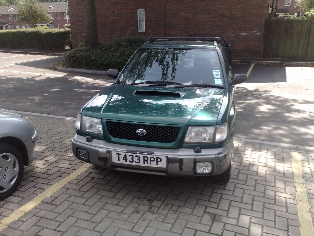

I am going to paint the silver plastic trim, bumpers, door bits ect.
As you can see the bumper has been replaced at some point, but whoever painted it had obviously never heard of primer. :icon_frown:
is there anything that I 'need to know' about paint and primer being applied to plastics? Do they distort when temps change? What will i need to do to prevent future cracking of the paint? Oh. And I'm going to paint it goldish. Wheels too. :biggrin:
