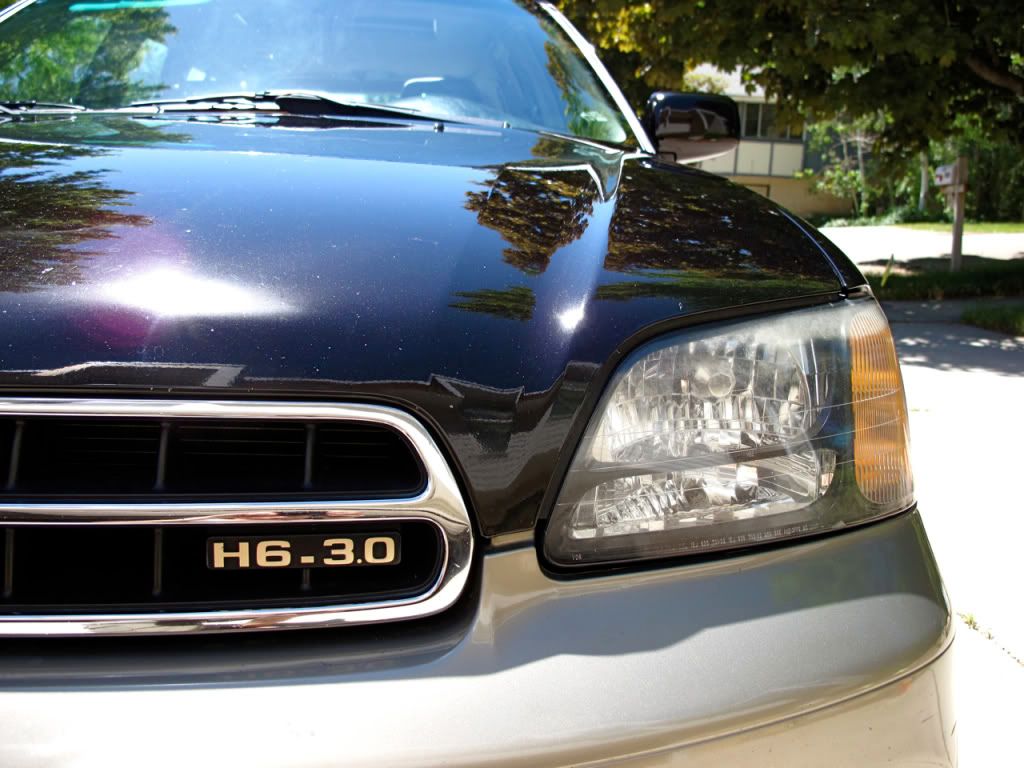

You can see a bit of the metallic flake in the paint. H6 baby!
