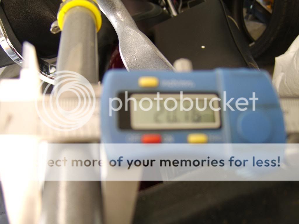

Measurements of the 2 sways. The oem piece is a weak 16mm. Yes, 16mm.

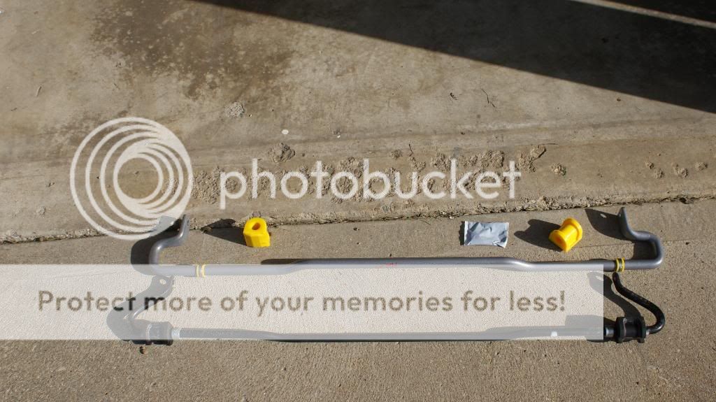

The Whiteline is 20mm.

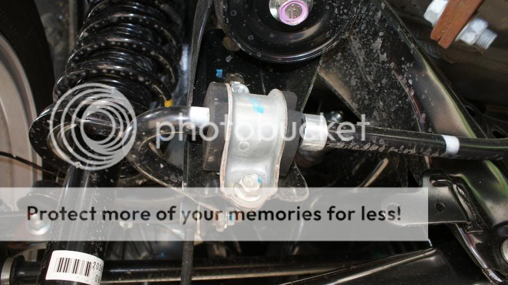

Stock sway in place.
Removing the RSB was as easy as 6 bolts

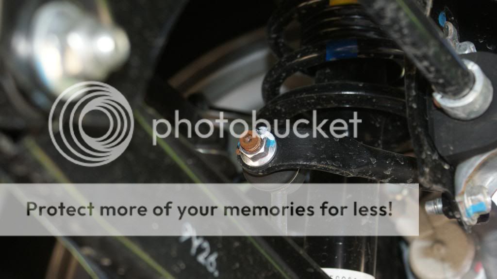

Remove the 2 shown here(on each side)
And remove this bolt(on each side)

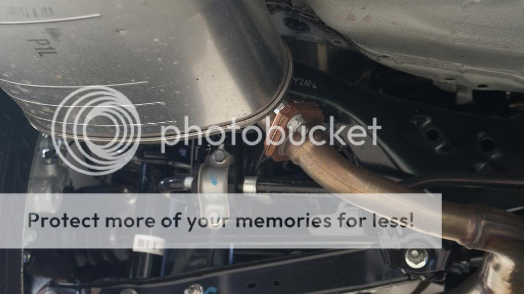

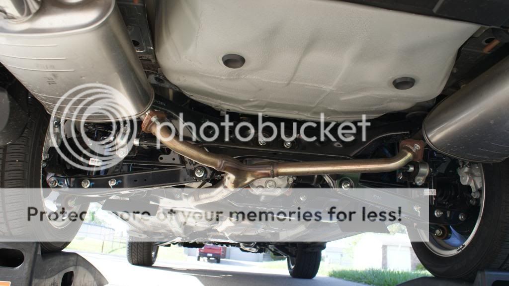

I installed the Whiteline with the letters correct side up to notice that it will rub the exhaust. A quick review of the stock photos showed the bar needed to be flipped.
