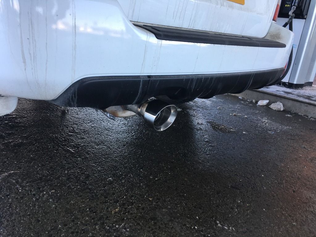

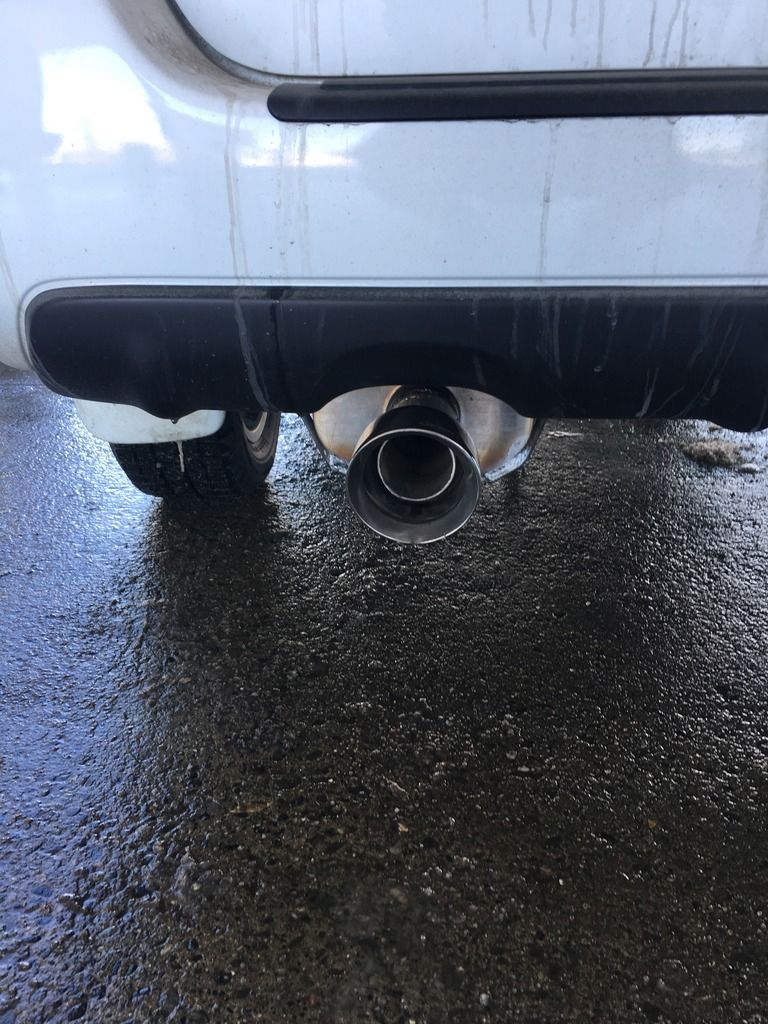

Alright!!! So I did a thing this weekend. It cost a little more all said and done, but I am happy. I go the 11255 Muffler (Magnaflow) and 4" tip welded on. The install was a lot quicker that I thought it would be, and in the end I "could" have just cut it off and welded it in. There was no need to bend and install pipe. Crazy. It still cost the same, but whatever. It is done.
As far as the sound: I remember now why I LOVE Magnaflow. Damn, such a good sound. I am pleased with the subtle deep tone. Being as it is an N/a engine, it could almost be louder, but for now I am happy. The higher end could be louder for sure, but for a daily driver... It is still a great ride without droning. I may do a high flow filter/aftermarket resonator down the road... maybe it could breathe a little more and add a tiny bit of sound.
The look: The 4" tip actually looks awesome. It fits the space well, and I am happy it worked out and wasn't too big. The tip I went with was a "Upower" cheap Chinese thing from Amazon, but it is supposedly stainless and double walled. I like that look. The logo was not centered right, but whatever. It is gonna be rubbed off eventually or dirty enough to not see.

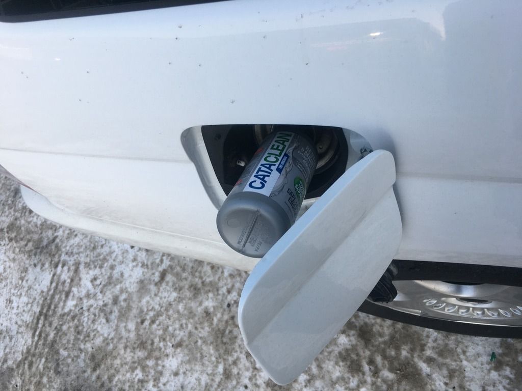

I am experimenting with some CATacleen. Supposedly it helps clean the cat a little and the fuel system. I say it's probably snake oil, but I figured I would give it a shot. I will update after a bit and see if it helps at all. Seems like the fuel trims and such were a little different. Hopefully it is gonna help.
I am still in love with my Magnaflow muffler setup. It sounds great! I am curious how it will be after it "breaks in". I have put about 350 miles since new with little change. Seems to sound a bit better after it warms up and the moisture goes away. It is a little black and sooty. Could be a bunch of things, but I will try not to worry too much.
