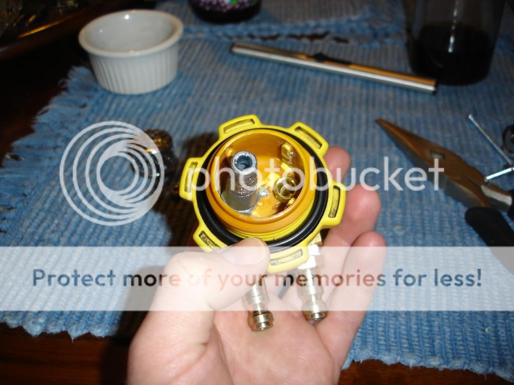

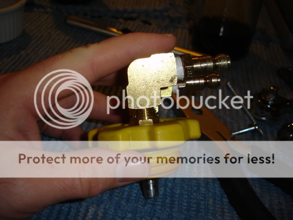

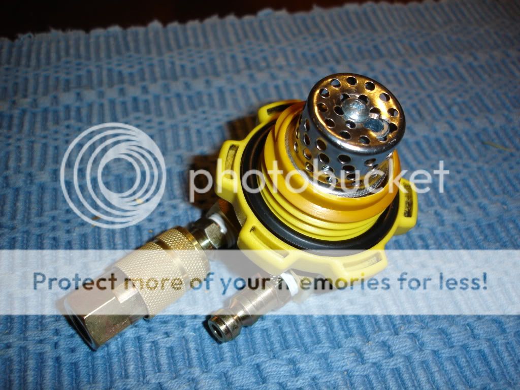

I see a lot of info on the Grimmspeed AOS on other forums, the principle is interesting, don't waste oil by burning it and keep you air intake clean and octane at the level you pay for. The only thing I was not interested in was the $300+ US pricetag. I thought I would slap something together myself. After about 15 minutes at Princess Auto and 45 minutes of my time fabricating I came up with the following:
The principle is simple, dirty air from PCV goes down the long nipple into the filler neck and the oil particles condensate and drop back to the crankcase -> the clean continues back into the intake through the nipple that is mounted flush with the filler cap. The space between the two nipples and the screen would allow for enough time to condensate. This system does the same as the machined one, just does not look as pretty. The quick connects were put on to allow for easy access, it would be a pain to have to unscrew clamps just to remove the oilcap. This is a first try only, not looking for ghetto-fab comments. What do you guys think?

Height might be an issue. I believe there isn't much clearance above the cap. Other than that I'd love to see a "budget" option!

There are no check valves other than the PCV valve in place, I do not believe the Grimmspeed or similar products have any check valves included in their system. The oil condensates and the clean air moves through the intake system. Are you concerned the engine will run lean?

The filler neck is not pressurized or you would have to fill it to the top. The oil system after the pump is pressurized, your BMW likely had the cap on the valve cover, and there is oil spray there to keep the camshafts and mechanicals lubricated. I think the key is to have enough space and some kind of screen to collect oil vapours and allow them to condensate and drop back down the filler neck. I don’t have much of a concern with water and other similar contaminants as they originate from the crankcase regardless. There’s more than one road that leads to Rome, I guess you could make a lot of different configurations. From looking at the drawings for the Grimm speed unit the vapours appears to just drop into the filler neck and over pressure gets released through the opening next to it and through a second groove located in the AOS. I do not think this unit would be much taller than the Grimspeed or similar units when installed as they get installed under and raise the oil cap. This fabrication just has a brass 90 degree elbow.

so from the pics it looks like the screen mounts flush to the long nipple? have you thought of maybe filling the space in between the screen and the cap with some sort of stainless mesh? to me that would make more sense in allowing only air to escape.
my only other concern is how well it will all be sealed after modifying the plastic cap. but it looks like you epoxied the fittings in so it should be good.
interested in how this works out for you.

Love your products, if you want to trade let me know. :D I know a lot of R&D goes into your products and it is not cheap to produce machine items. The Dutch in me just squeeks when I see the price tag + shipping + duty + tax +UP(S) the donkey fees. I had an extra oilcap and just had to try something as I wanted an AOS to keep the intake clean. For 1 hour of time and $25 and a first try I don't think it's half bad.

Only thing left to do now is slap on some clear tubing and put that baby through some trials. Where Grimmspeed and Prova differ is that the Prova unit doesn't deal with the PCV system.

I think I'm missing something with those AOS on stock oil cap. How it can work? Cause the stock pcv line contain oil vapor(that crap the inside of the intake), so how putting it on the top of the oil cap can change something. From what I saw on this diagram, the baffle are on the 'in' section, not the 'out' section. So their will be vapor coming out of the cap? No? And if their still oil vapor from the oil neck, why condense the oil coming from other part of the motor?
