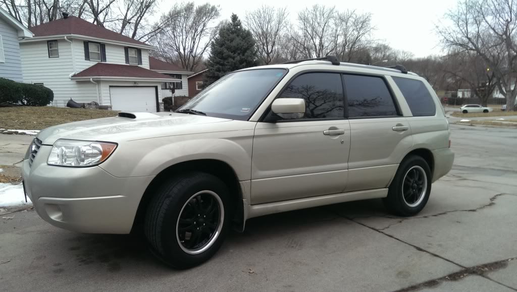

Just took a quick pic in the shop after I put them on.
I'm really pleased with the way they turned out, they're subtle but different.
