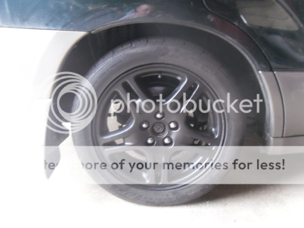

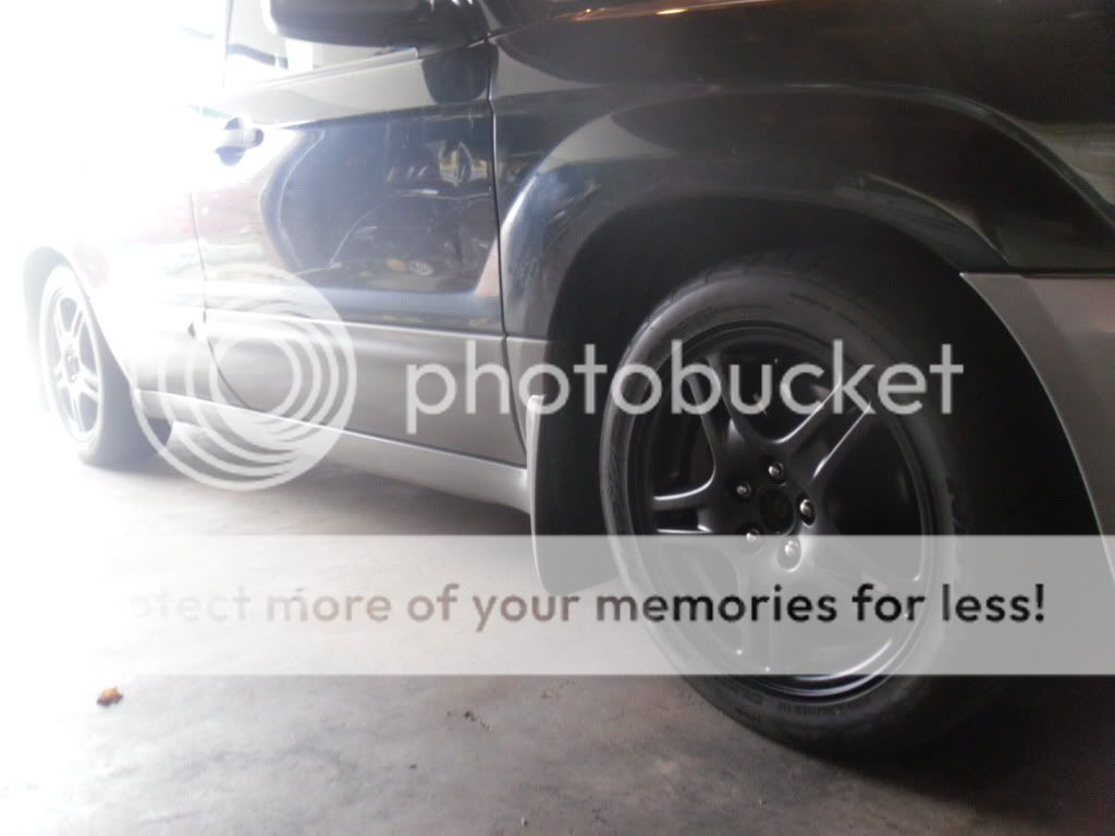

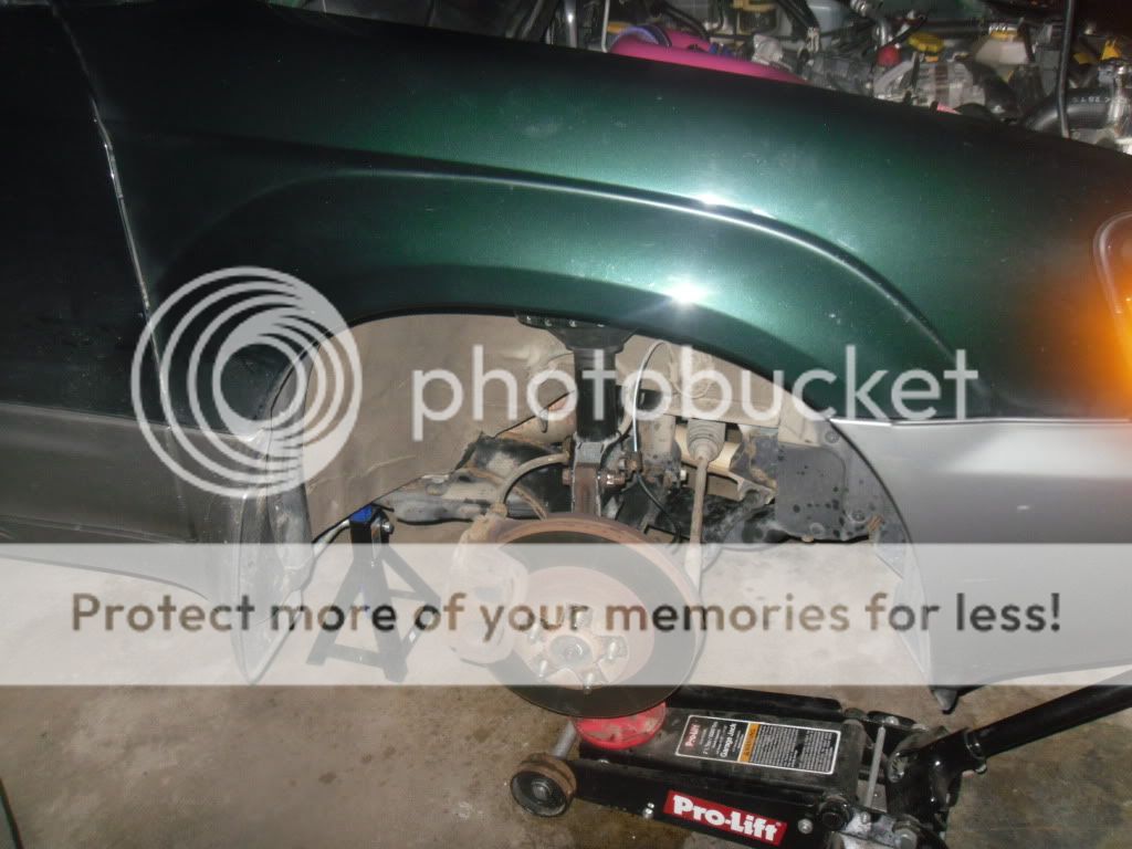

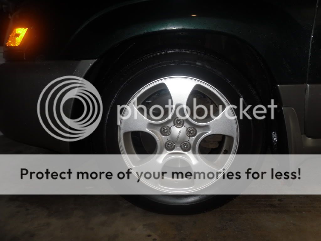

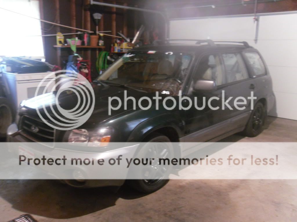

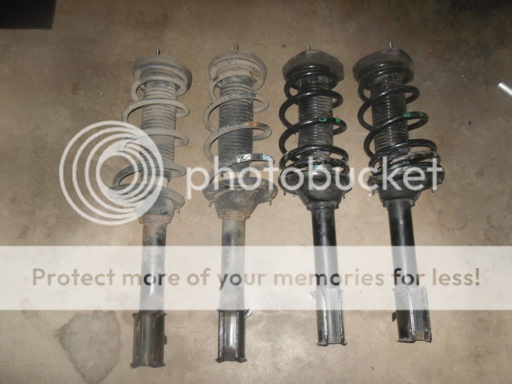

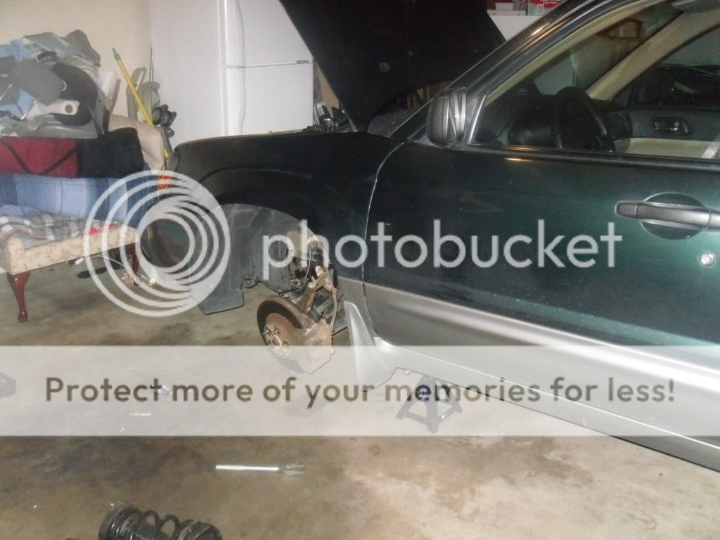

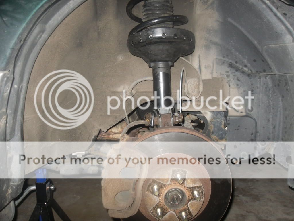

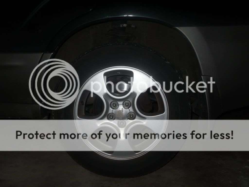

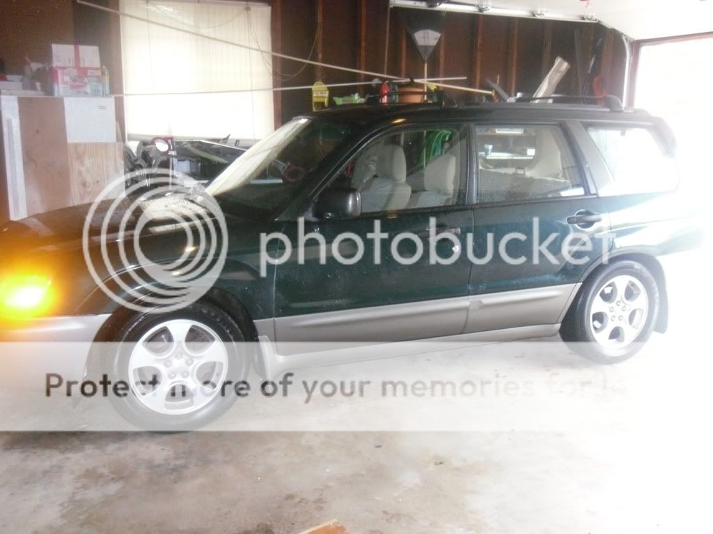

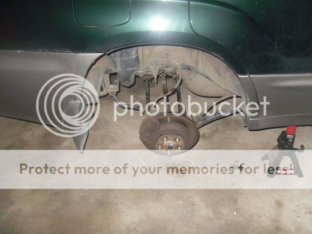

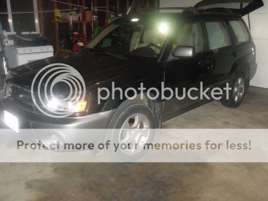

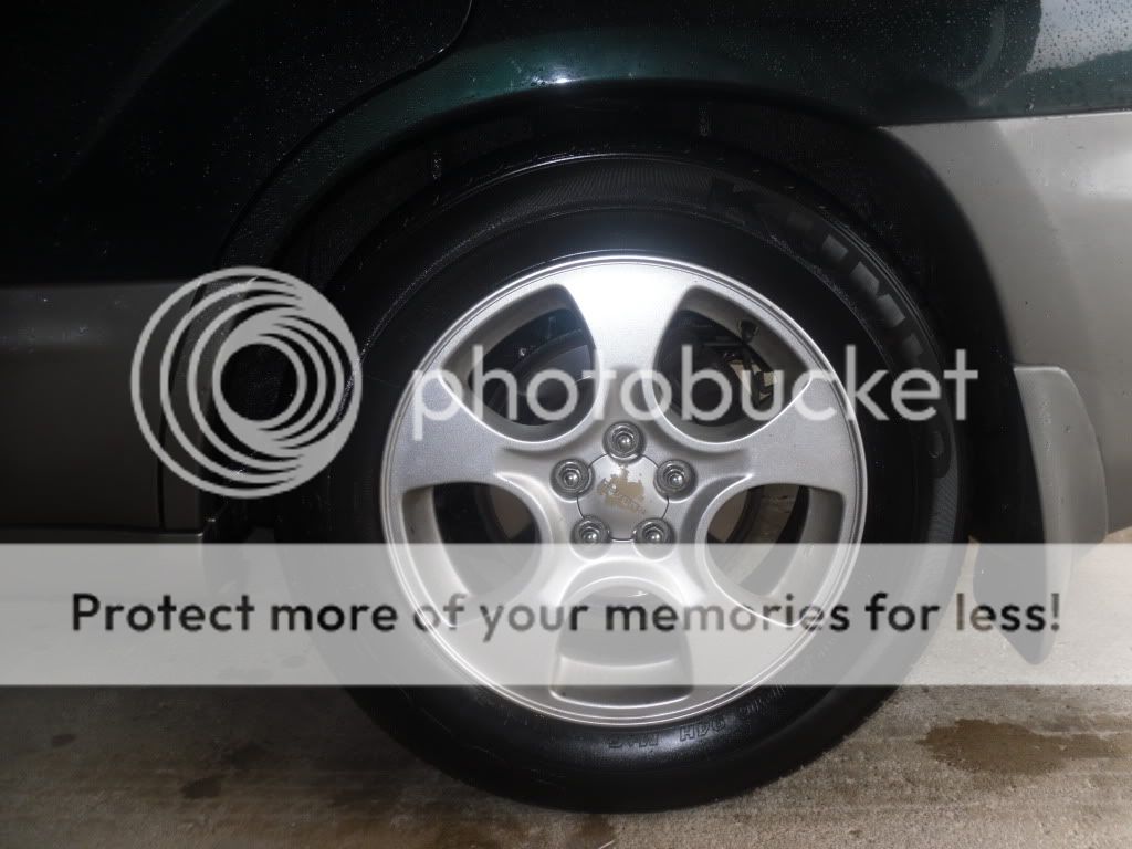

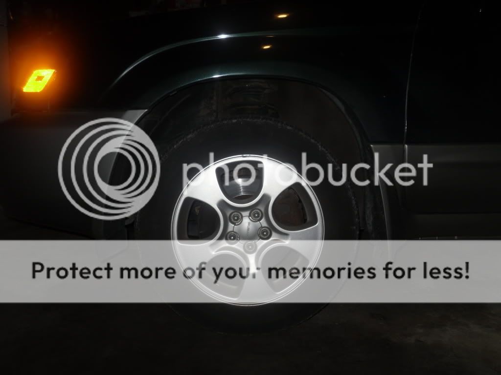

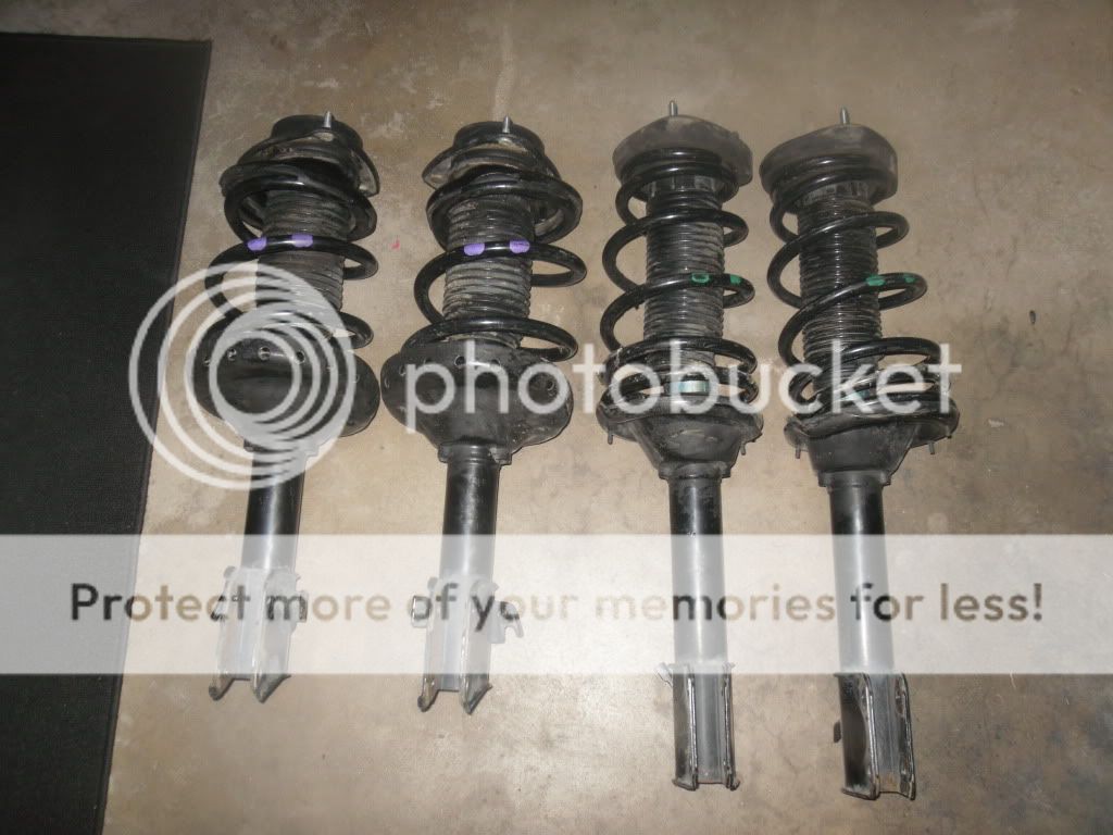

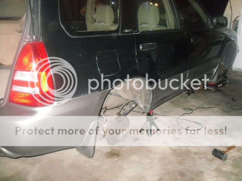

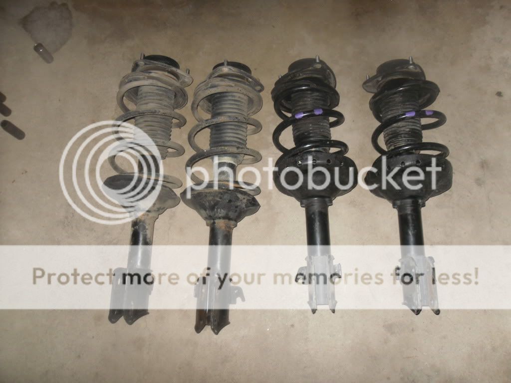

Picked up some 07 WRX struts and tophats with only 25k on them off of ebay for $95 and that was plus shipping. My bro gave me his set of 04 STi springs that he has had forever. Had a time installing them and even the wife lent a hand. Night and day difference for handling and the body roll has almost completely vanished. The only bad side is that my wife hates that I lowered the car 3 inches. Welp here are the picks of before and after. Tell me what you think.

It is great, isn't it? My wife did not oppose the lowering program here at all as she understood the difference. The car is so much more responsive during turn-in and stable. It may still need a sway bar or two to really solidify it, but it's night and day better at this stage.

Use the 04 STI 20mm rear sway bar. Even our NA Foresters seem to be running 04 STI compatible suspension (rear, don't try turbo front sway bars). Don't forget the mounts and the brackets since you're lowered.

Measure from the center of the wheel to the top of the fender on the front and back. Im about 3/8" low in the back on wrx springs/struts

I have butt sag with '05 STi springs. I got over it quick, if you like the handling as-is, I wouldn't add spacers -- stock STis have butt sag too.

There's a difference between the WRX 20mm and STI 20mm in the width (and also the way it sits IIRC). The WRX one should come up short but you could always give it a try and see.

I think the only reason Im lower is because the tires on the rims are only a 205. They dont come in 215 or whatever the stock size tire is. So when my bro bought them he stepped down in size. I have already scraped my mudflaps a couple of times cause they are redoing the road outside our house and there is a huge diff between the old road and the new one. As for the swaybar, Ill try it and if it dont work then Ill shell out the 100 bucks for a STi one. Im just trying to MOD on the cheap and so far I have only spent about 900 bucks on parts and 600 of that was for my catback.

The wrx bar won't fit right. It's designed to use droplinks that bolt to the bottom of the lateral links and is a different width (its the same setup as 02 and earlier SF models, SG 03+ foresters basically use lifted STI suspension/geometry).

What size of tires are you running? The height looks good! :rock:
I installed a set of JDM STI Spec.C my06 struts and springs and now my skid plate is really skidding on speed bumps... Might have to go back on originals for the winter. My tires are 225/45-17 and the car seems to sit a bit lower than yours.
edit: ok, i saw the post about the size
