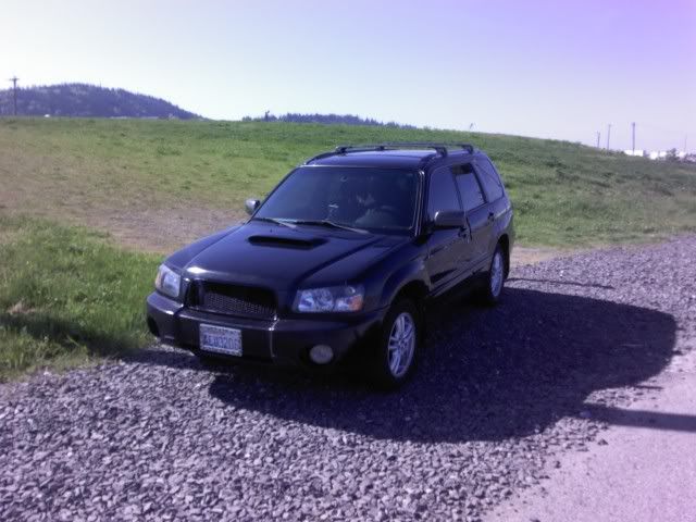

I work as a dog trainer, and I drive my own dogs around all the time, so my main goal is to make my Forester as dog friendly as I can.
When I found this 2005 XT, it had several mods that I liked, and one or two I didn't like so much. I appreciate the black out lights on other other folks's cars, but it is not my favorite. The black out polished off pretty well.
-timing belt replaced
-serp belt replaced
-water pump replaced
-front brakes pads and rotors, rear brake pads
-new muffler,
-new hood scoop baffle
-valve cover seal replaced
-fired extinguisher bracketed to dog guard
-first aid kit carabinered to dog guard
-window noise project completed: aquarium tubing in lining, electrical tape on frayed gusset edges, cloth-coated pliers on gussets
-monogrammed rear seat cover/dog-proofer
-Yakima Load Warrior with extension
-Thule 1600 Atlantis cargo carrier
-Bulmastiff and Rat Terrier stickers galore, paw print license plate covers
-Tow hitch installed and Glide Away bike rack procured (with folding arms)
-Pioneer Bluetooth streaming hands free stereo installed
-Removed stickers, replaced rear lift gate (needed new wiper and latch and paint)
-Replaced rear bumper cover
-Modded grille by cutting our plastic inner, adding screen and rhinestone paw print

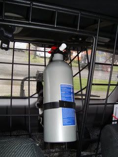

Fire Extinguisher and Swinging Bike Rack pics.
Fire extinguisher bracketed to dog guard, and bike rack in new tow hitch. Bike rack has been incredibly useful already, allowing dogs in and out of back while bike(s) stay on rack. With luck I will never have use for the extinguisher, but good to know it is there.

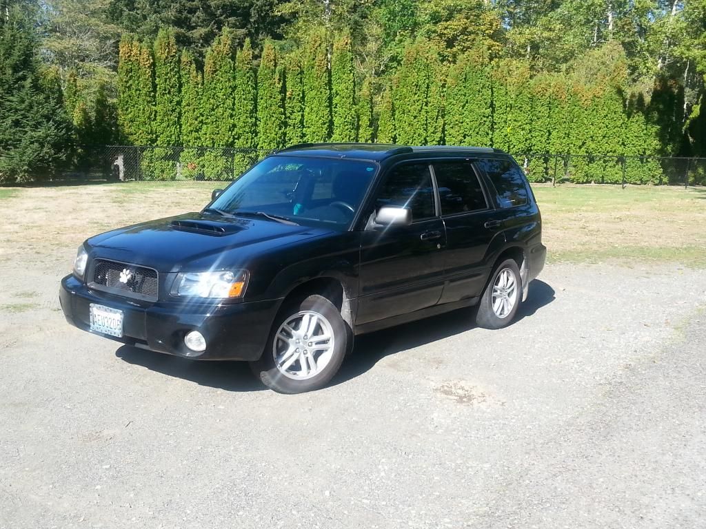

Grill Mod: $10 work in progress
My old grill was cracked and rattling, but the wife is a little irritated with $ on car lately. My dad and I tried to do a grill mod for under $10... It is a little funky but it was fun. It is still a work in progress.
