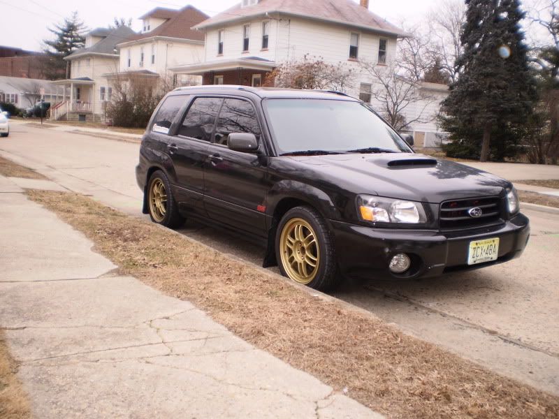

9/23/09: about a week after i bought the car. tags came in, i was debadged as of the second day i had the car. bought some STi decals for the front doors, and a tuned by STi badge to cover the holes from "forester" also, put in hella supertones, mudflaps, and painted the grill black. the intake and short throw were also on by here.

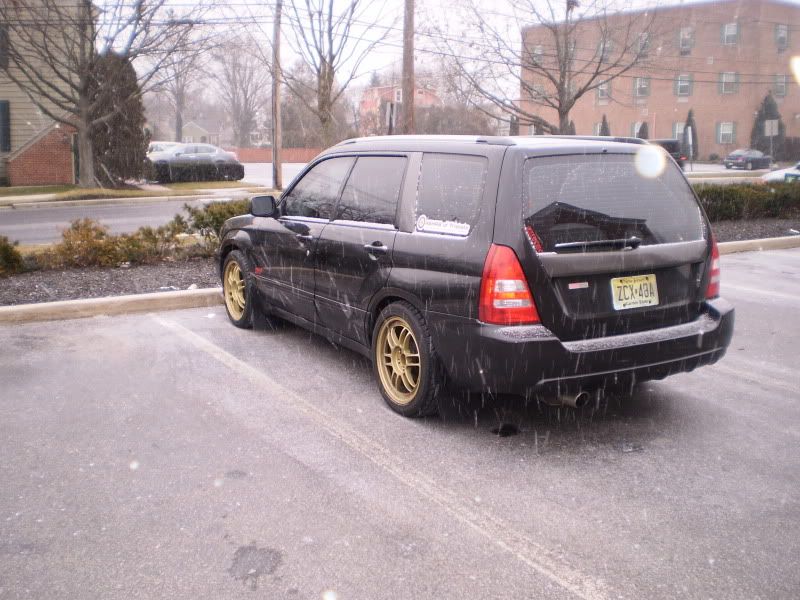

2/27/10: the car as of late. with all of the snow we've been getting here in jersey, i took off the enkei's and put my stockers and all seasons back on. painted black though. ill get a picture soon. p.s. this is with the sti struts and springs and 1/4" saggy butt shims.
