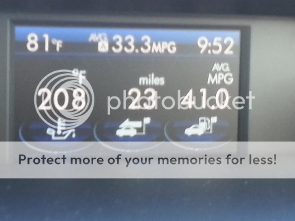

See the attachment below from my 20+ mile commute this AM. I often get 36,38, even 40+ MPG on my daily commutes at 70 MPH. I never pass my 70 on daily since the roads here are marked to 65 MPG.
It feels like bizzaro world when my MPG average is actually hurt as a result of road trips. LOL.:icon_biggrin:
