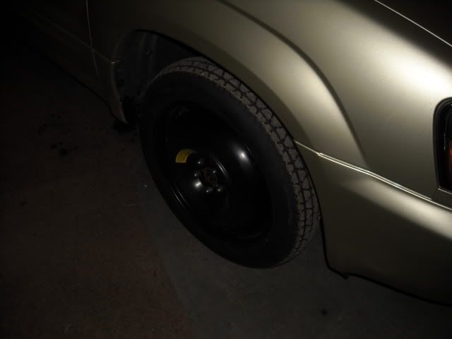

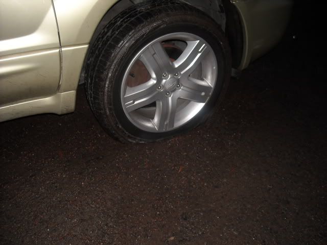

Okay its not going to be crazy snow like you guys get over in the east but for a person born and raised in sunny San Diego, CA its going to be a snowy day (expecting 14 inches of snow tomorrow).
My family decided to take a snow trip to our local mountains in Big Bear CA. On our way up I either ran over a rock or a pot hole that ended up blowing my front right tire. I have 09 forester rims (17in) on my 04 xt. Luckily the person I bought them off of included the spare tire. So here are my questions.
1. Is this the correct spare tire? 155-70-17 (im running 225-55-17s)
2. I know many of you say not to use snow chains/cables on the forester but should I consider it since im running on the spare tire? And if so, should they go in the front or rear?
3. Where should I put the spare tire? (Leave it on the front pass side or move it to the back?)
Thanks for all your help. Sorry if these are newbie questions. Ive only owned my forester for a little over a month.
The popped tire
The Spare

Put the spare on the back and move one of those tires to the front, and pull the 4wd fuse as stated in the owners manual.
[/B]
Actually you install the fuse in the AWD slot. Just clarifying. ;) If you get stuck, I would pull the fuse and as long as you are on snow it won't hurt to run for a short distance in AWD
I wonder if the '04 came with a full-size spare? :confused:
If so, there wouldn't be any "space saver" specific instructions in the OM, and there doesn't appear to be an AWD disconnect fuse position. A quick review of several Forester OM's suggests that the temp / donut spare wasn't introduced into the USDM until the '06 MY. Accordingly, the small temp spare may not be a particularly good idea at all for the OP's application.
Check the vehicle placard at the bottom of the driver side "B" pillar. It'll identify size(s) and pressure(s) for the road wheels and spare. An example from the '05 OM is attached.
Either way, I'd recommend a full-size spare (compatible with the after-market 225/55R17's and not the original tire size) for the car.
HTH,
Jim / crewzer
2007 SG9 Forester XT Stick Shift
1,667 Posts
09 and 04 AWD is slightly different. 04 have LSD in the rear and its not a good idea to use different size tire. If you are running in FWD the rear LSD might still lock up since its viscous clutch heat up due to speed difference. The temporary spare are not supposed to be used longer than 50 miles.
I would still move the spare tire to the rear and insert the AWD fuse but would not drive it longer than necessary. Get the tire fixed ASAP.

Okay I put the spare in the rear and the full size in the front. My question now is regarding turning the car into FWD. I took a look at the fuse box in the cabin. This is what it looks like:
I didn't see anything that said AWD or FWD.
So I pulled off the fuse cover in the engine compartment and saw this
On the top right position (between the barcode and Fan 1 relay) is a spot that says FWD. Is this where I should stick in a fuse. If so, what size fuse. I think the biggest one I have is a 30.
Again thank you all for your help. You all made it possible to enjoy this family vacation by helping me with my problem/worries. Oh here is a picture of what it looked like outside in the morning and its been snowing the whole day.
2005 Forester X
225 Posts
Don't think it matters what size fuse you use. Very little current is flowing through it.
Another related question to your thread: I plan to do a 5 tire rotation w/ my new Geolander A/T-S, but the rim on my full size spare in my '05 doesn't match the other 4 (black, like in your pictures). Should I just grab a matching 5th rim at a salvage yard? Any problems with fit in the spare wheel well?

Here are the instructions from the 2006 OM:
NOTE
(All AWD AT non-turbo models without
Vehicle Dynamics Control system)
Before
driving your vehicle with the temporary
spare tire, put a spare fuse inside
the FWD connector in the main
fuse box located in the engine compartment
and confirm that the Frontwheel
drive warning light “AWD” in the
combination meter comes on. The all
wheel drive capability of the vehicle
has now deactivated. After re-installing
the conventional tire, remove the spare
fuse from the FWD connector in order
to reactivate all wheel drive.
And here are the instructions from the 2007 OM:
NOTE
(All AWD AT models) Before driving
your vehicle with the temporary spare
tire, put a spare fuse inside the FWD
connector in the main fuse box located
in the engine compartment and confirm
that the Front-wheel drive warning
light “AWD” in the combination meter
comes on. The all wheel drive capability
of the vehicle has now deactivated.
After re-installing the conventional tire,
remove the spare fuse from the FWD
connector in order to reactivate all
wheel drive.
I don't understand the 2006 comment about the non-turbo...:confused:
Looks like just about any fuse size (5A?) should work.
Your pix indicate the temp spare is installed at the front right position. It needs to go to a back wheel position.
