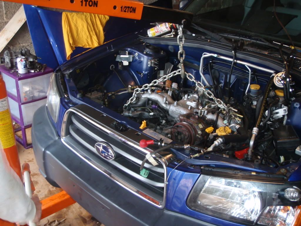

Next phase.
Did I mention that in order to clear out the garage required moving TWO 1940's Jeep Willy's chasis and an International Cub Cadet riding lawnmower?
Moving the Willy's (and 4 flat head's) sucked, but moving the Cub Cadet spawned a new drinking game! :Banane17:
Its called: try to get the lawnmower sideways.
Now, if I could just get the crank pulley bolt to break loose then I could see where all the trouble started. Looks like I should have gotten a better air compressor... :icon_rolleyes:

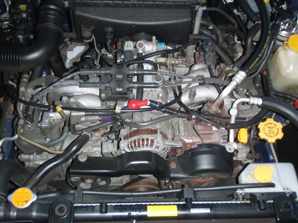

Looks ok from here. At least it didn't go through the head...
The new one, sans AC pump. Had to swap the bracket off of the SOHC.

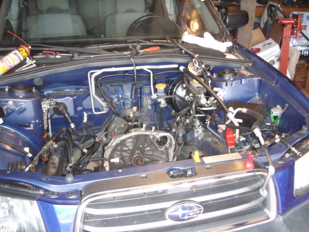

Now, I started this out with an open mind (maybe a little too open :icon_redface:) and confidence in my abilities. I know how an engine works. I've torn them down and rebuilt them in a timely fashion - it was my job. Anyone COULD do this, but I would hate to have started this project with any less experience. That being said, I am currently lost on the wiring - but we'll get to that later.
Advice - If you are going to do this: GET A WHOLE DONOR CAR.
It would have made things sooo much easier instead of having to piece together every part. I wish I had just spend $200 to get an insurance auto auction license and found a good candidate. I probably would have saved money and time in the end too.
Goodbye fenders.
And silly downpipe-less exhaust
Interior's gotta go too.
