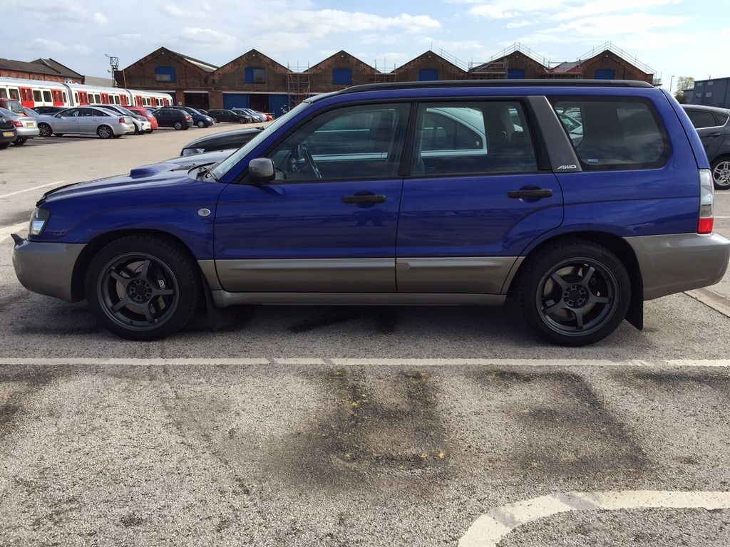

Hi,
As all other members I want to share with you with my Subaru Forester 2.0 XT 2004 mods list and experience. My story have began in this year on 10th of March when I bought my dream Subaru.
This is a first photo I took just after I've bought my car.

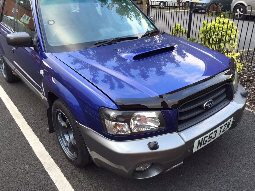

This ts is how she currently looks:
The current modification list (last update 19/07/2016):​
