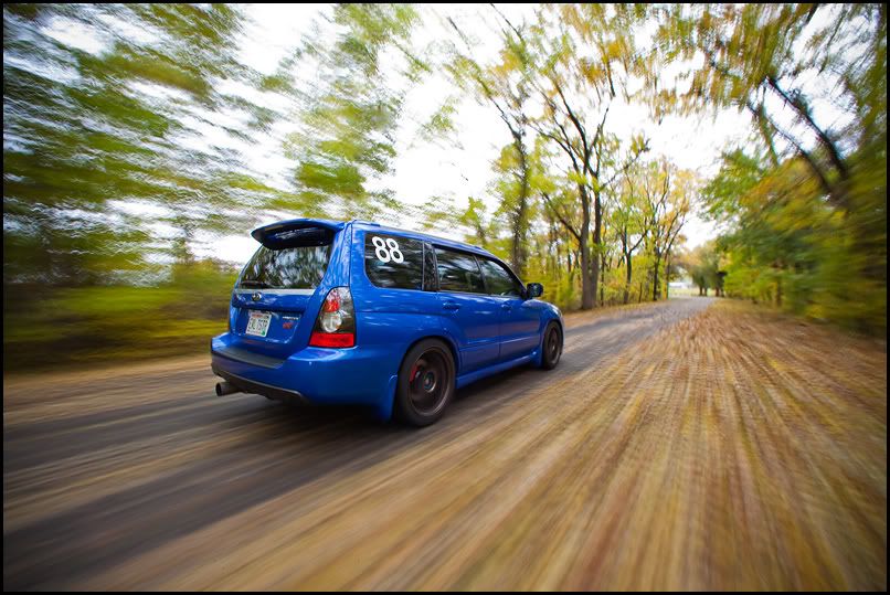

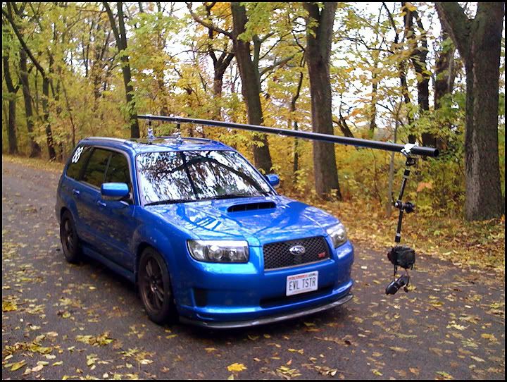

I've always been fascinated with rig shots, but have never been able to actually get to do it. My biggest question is the rig itself. I take it some post-production Photoshopping takes care of the boom, or is there some lens trickery involved? Have any of the raw shots?

At 2-3 mph I don't think aero matters... LOL...
Ya, I had to Photoshop the rig out.

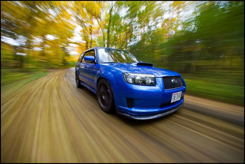

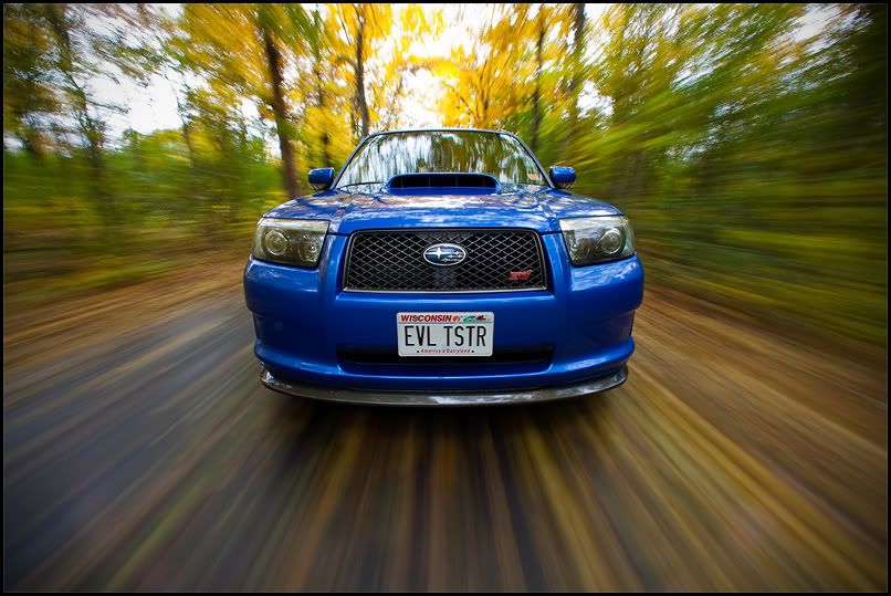

Wowzers... great colors! Do you use a remote to trigger the shutter?
Yup, I use Pocket Wizards to trigger the camera. I pushed the car from the back and let it roll in neutral while triggering the camera. The shutter speed is around 2.5-4 seconds and the car is only going 2-4mph....

I am not getting the motion that you get, granted I am only @ 1/15 sec, I guess I need to do a longer exposure.

Very nice photos. What aperture did you use?
Can you post the exif of the pics?
I started out at f/22 and as it got darker out I moved to f/16. All exposures were between 2.5 and 4 seconds at ISO100.
