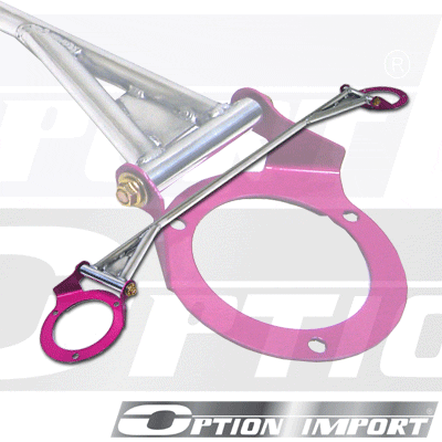

It would seem many people are running this one,

there's alot of those on ebay right now. I'd have to repaint the pink, it says "Front Up Strut Brace Bar Subaru Impreza WRX STi 02 - 06" but i assume it should fit and 02SF too

I bought one of them for my 98SF, i think it was the 02-06 one, and it didn't fit. So make sure it will fit before you make the purchase. :)

For an SF front you need a pre 01 'classic' Impreza bar, SG uses the later front, both use the 02-> rear bar.

"The Rookie" has it right. The SF has a weird setup. You need the 93-01 Impreza bar up front, and the 02-07 WRX/STi bar in the back.
