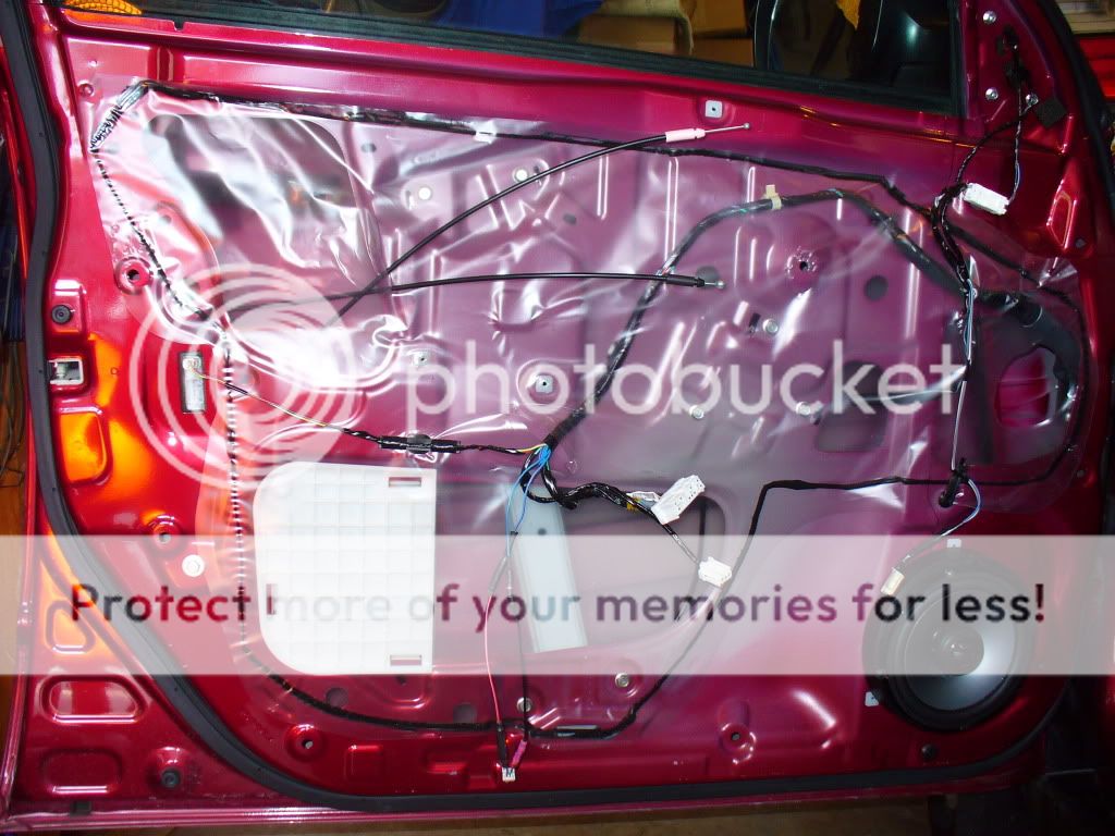

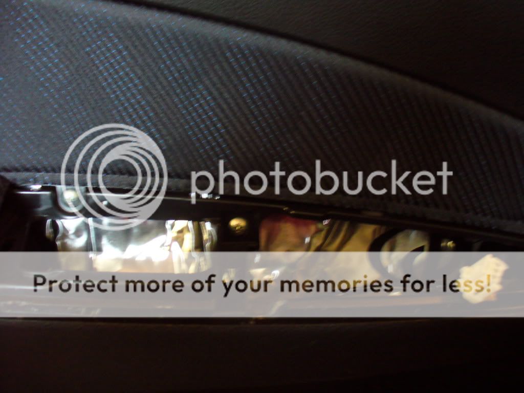

So you are left with this:

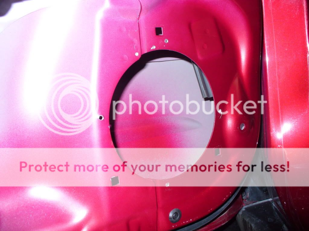

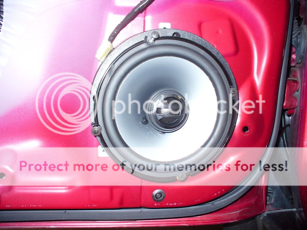

To install the Speaker kit, First remove the speaker. (For reference, I have Alpine Type S Speakers, so there is a spacer that Must be removed)

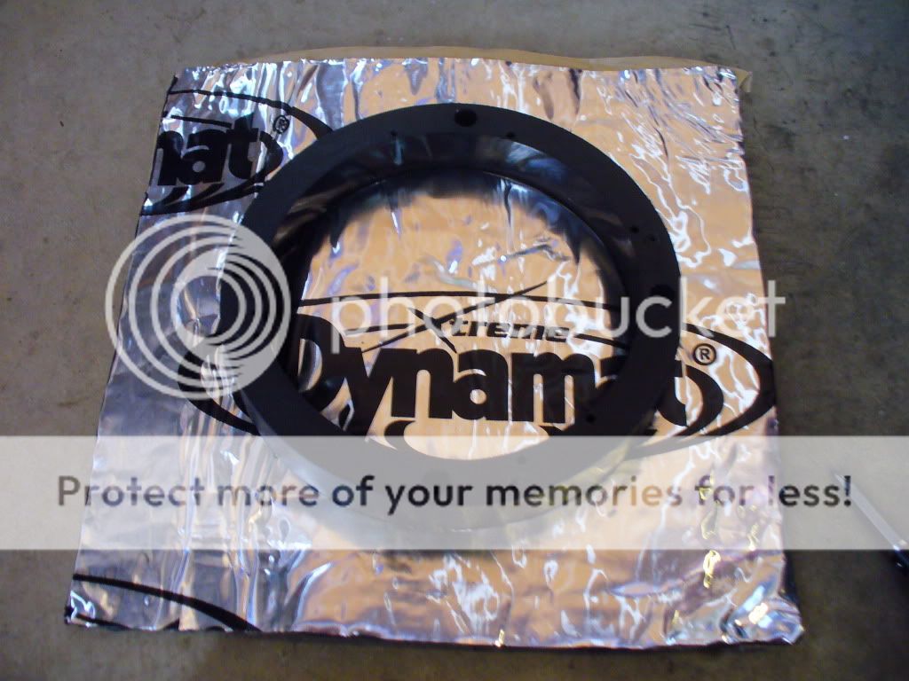

Next (This is specifically for those with spacers), You can easily mount the spacer on the 10"x10" Dynamat, and simply put the screw through it based on the Spacer. That way, it makes for a perfect fit on the door panel

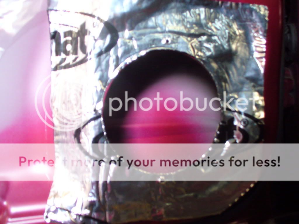

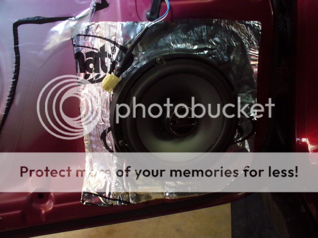

Afterwards, You can take a knife or box cutter (I used a Pocket Knife), and simply cut out the circular space to place the speaker.... And then simply pull off the paper lining and attach the Dynamat to the door with the speaker opening. Make sure the holes line up with the hole openings so you can easily line up the spacer. Make sure you flatten out the Dynamat so it sticks to every contour of the Door frame.... This will help you achieve the maximum Sound Deadening for the Foz. One thing to note... With the speaker wire, You can run it behind the door panel, or run it behind the Spacer.
Next, Just simply reattach the Spacer and the Speaker, and You have the Speaker Dynamated!

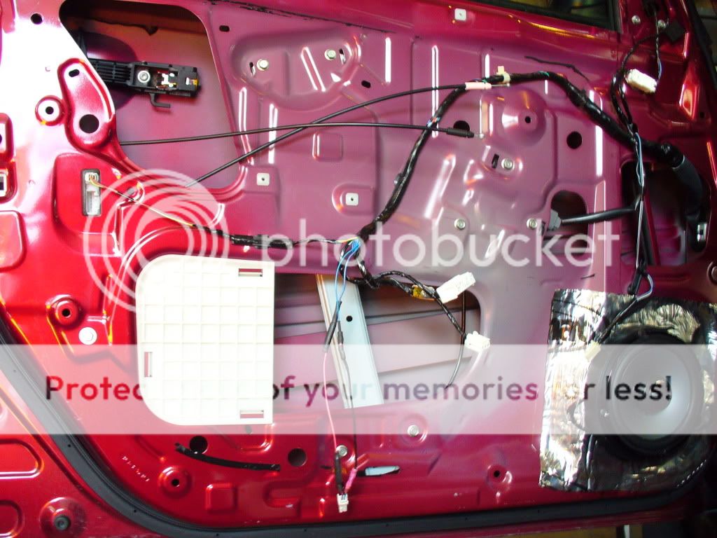

This is pretty straightforward as well. First, You must pull off the plastic lining attached to the door. This comes off with ease

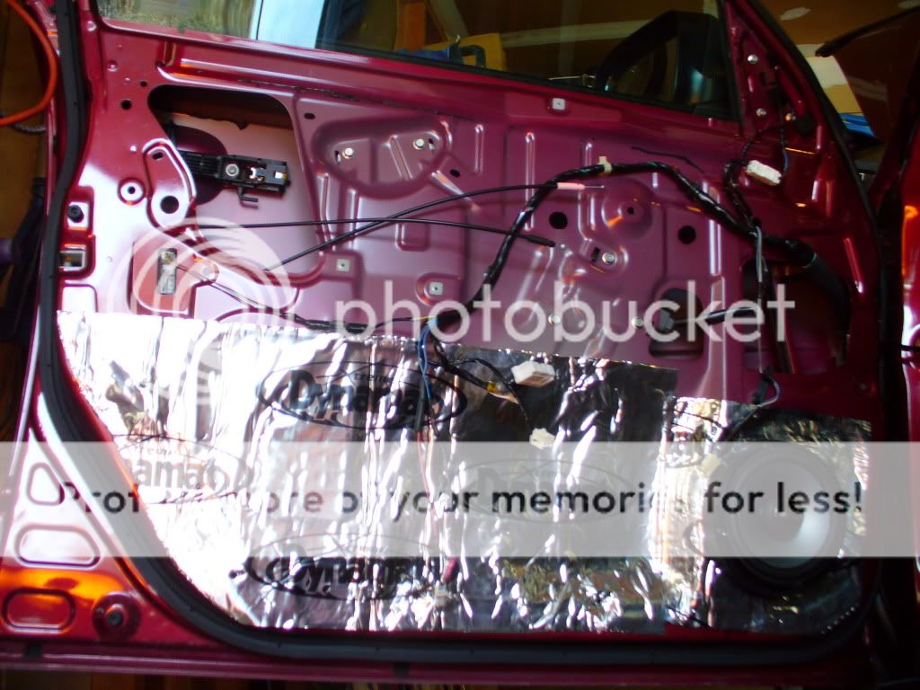

Next, Start with Dynamating the bottom half... This is the easiest place to start. Line it up with the bottom of the door panel matched to the dynamated speaker. The door trim attaches to the Door Panel with clips along the sides of the door, So make sure you know these locations, making it easier when you re-attach the door panel.
Pull off the paper lining of the Dynamat, and starting from the top, line up and attach the dynamat to the door. Carefully and precisely attach the dynamat to every curve of the door panel.... Where there's an opening for the door trim's clips, use a Screwdriver and poked a hole through the lining at each clip opening location. Cut off any remaining excess Dynamat that overlaps the door panel and save it for later use.... This is the result:

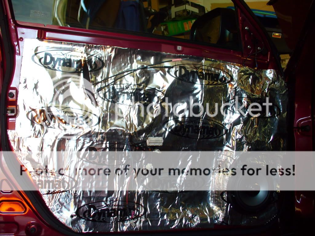

Next comes the Upper part of the panel. This is a bit more tricky, since the wiring for the door handle, as well as the wiring for the Door switches is on here. The easiest way is to line up the Dynamat on the door, with the existing dynamating on the lower portion of the panel, and figure out where the opening is for the door wiring. Then, Just simply take a knife and cut a small opening for the door wiring. Then simply pull off the paper-lining, run the door wiring through the dynamat, and attach to the door, making sure to line it up with the lower dynamated panel. Remember to check the location of the holes for when you reattach the door panel, and use a screwdriver to poke a hole through the dynamat..... And cut/remove any excess hanging dynamat from the door.This is your end result:
Then, using the PDF file i mentioned earlier, re-attach the Door Panel.
And there you have a Fully Dynamated Door! :woohoo:

Jon the Baffles Nasarog is referring to (I believe) are the White, kinda square, pieces with the checkerboard pattern on them in pic #2. I'm guessing from your response that you just Dynamatted over them without securing them. There is a write-up here. There wasn't a TSB on it but Subaru is/was aware of the issue. Since it looks like you haven't had it done I really wouldn't worry about it. The dynamat should hold it just fine. It ain't gonna vibrate/move now.

Is there a purpose to the white plastic checkerboard thing?
Does removal affect anything?
Honestly, I have no idea... Don;t know what its purpose is... But the way it was fastened to the door, It looks like it could easily be popped off... I jus didn't bother so I just Dynamated over it.
2009 Forester XT Limited
1,525 Posts
Just FYI........It probably has a purpose as I don't think Subaru would have gone to the expense of designing it, manufactuing it and putting it there. Some here have guessed that it is for safety purposes during a side impact/collision. Protecting/adding protection to the passanger compartment from internal door parts. I don't think anybody here really knows except the design engineers. I wouldn't remove it!
